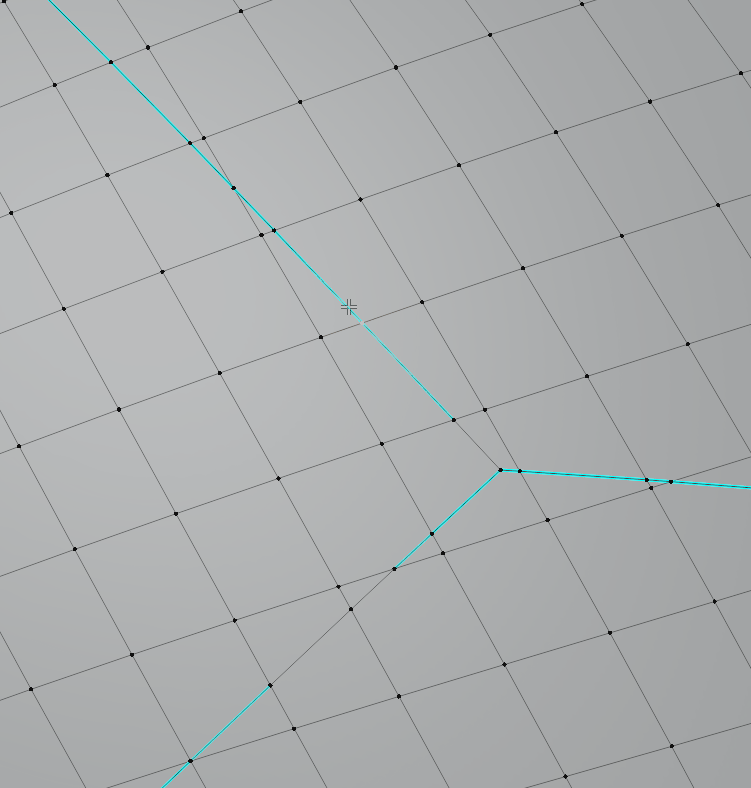

I’m not sure the process in C4D, but I’ve imported the OBJ into blended and it looks like its not isolated chunks. lots of vertices (but for some reason not all) are welded together, and the internal faces probably need to be triangulated to avoid rendering errors.
