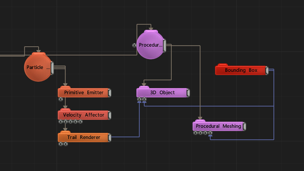

Yes, you can by connecting the output of the “Trail Renderer” into a “3D Object” node in your Procedural.
Just make sure the “Animate SDF” option is checked in the “3D Object” attributes, so it follows the trail animation.
Something like this:
You might also need to make the “Distance Offset” in the 3D Object a NEGATIVE NUMBER unless you have really thick trails and make sure the Trail Renderer “Primitive Type” is set to “Extruded Geometry”.
