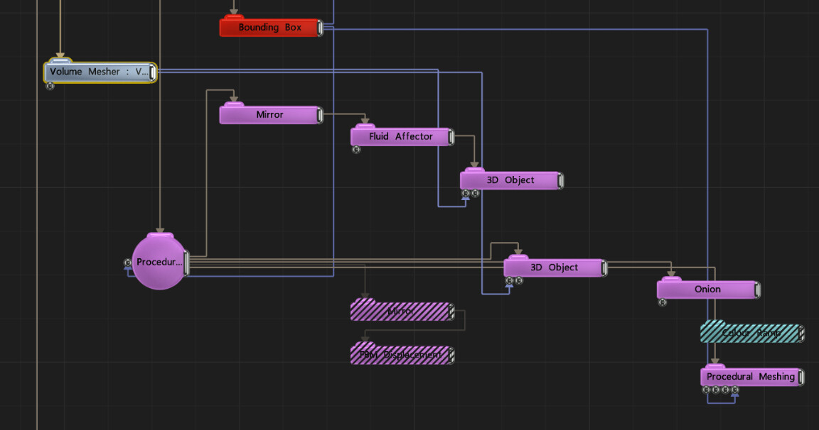

Hello,
Have a basic nodegraph that uses a 3d model to procedural. I am adding the Fluid Affector to the Procedural hierarchy. Everything works as expected until I hit the Jump to Start of Layer button. The mesh disappears once that button is pressed. Can’t get the mesh to show up again, unless I delete the existing Fluid Affector Node and replace it. Is this normal behavior?

Hi, having the same issue here, I am not able to render out my scene, any workaround so far?
If I connect my 3d object to the procedural’s root node - the 3d object appears in the viewport - then I delete the connection - and after that
the fluid effector works - but I could not do that for rendering - is there a way to reload the setup at rendertime? The same issue when I reopen the file, or when I jump to the start of the timeline.
(actually i am having a deadline - so would be nice to render it…:frowning:
this was solved privately in support, so just following up here. It looks like the 3D Object node doesn’t get updated underneath Fluid Affector, but you can trick it into activating by adding a Procedural Null set to blend, setting the blend amount to 0, and adding it as a second parent to the 3D object and childing it to the root. this tells the 3D object to activate, without actually contributing to the scene.
