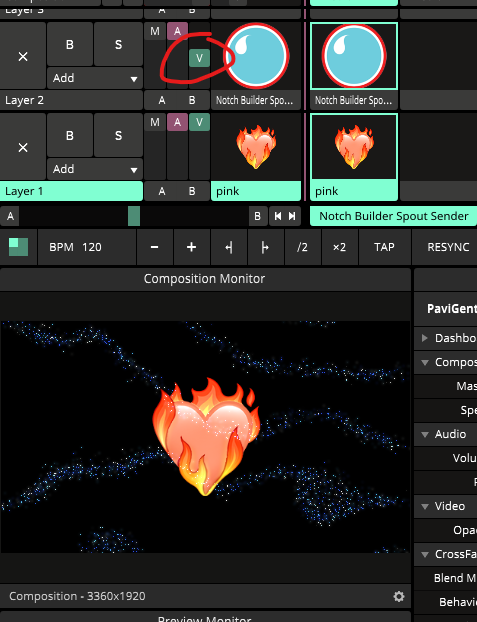

Is there a way for Notch to Spout the output with the alpha? Currently I have a scene with particles and when I spout it into Resolume the black areas (blank area/no particles) are still visible. Is it possible for Notch to spout without the black area and just the particles?

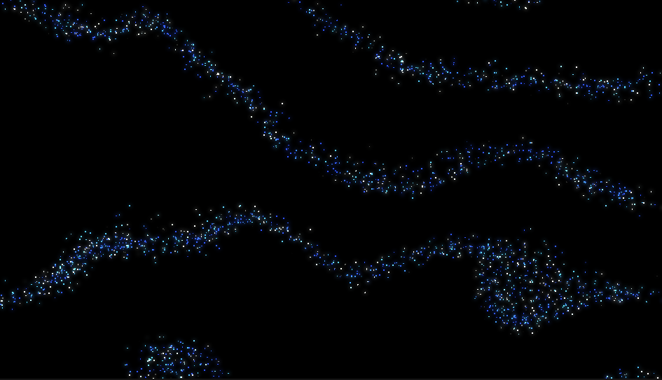

this is the scene
no I don’t want to lower the alpha through Resolume as it will affect the color of the original spout

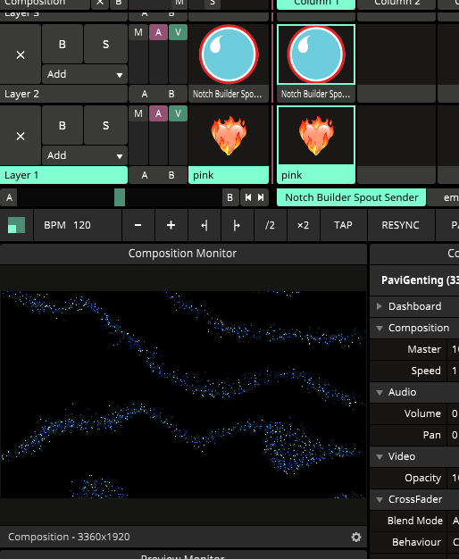

I’ve gotten it to work! Just had to change the composite blend mode in the root node from solid to ‘Blend with Luminance As Alpha’
