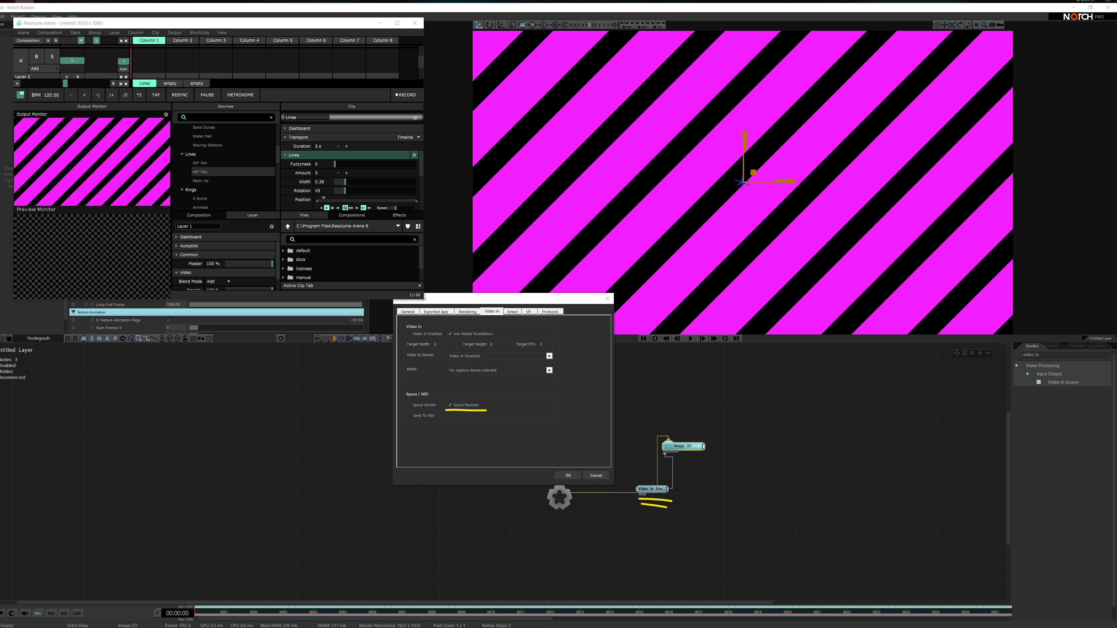

Is it possible to SPOUT Resolume into Notch on the same computer?
Right now we are running Resolume out an NDI through a network then back into Notch. Is there a setting or a Node that would allow the SPOUT out of Resolume to be read by Notch?
Yes it is possible, you just need to enable Spout receiving in Settings> Video In tab and use Video in source Node.

Got it! Thank you so much
