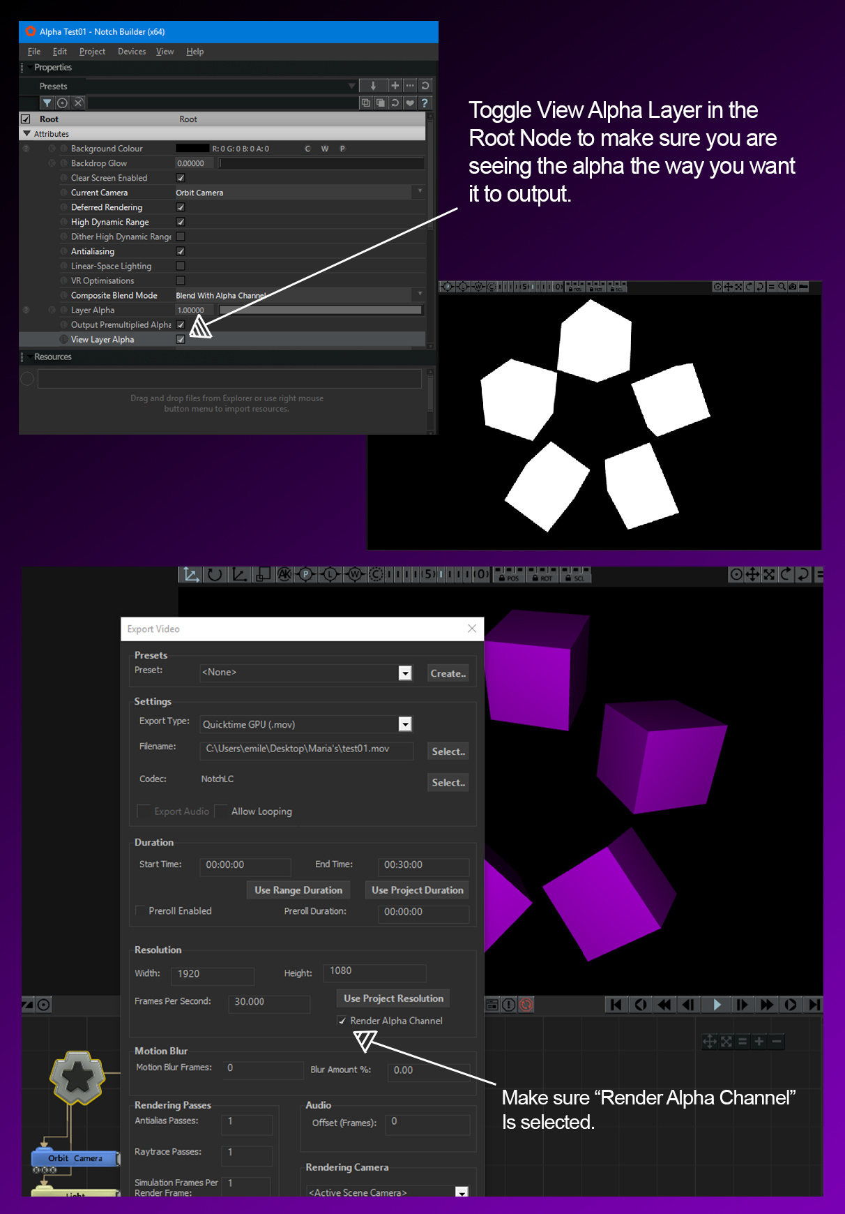

Hey There,
NotchLC does support alpha - did you make sure to also enable Alpha in the Video Export?
It might also depend on the application you are using NotchLC with.
If you could upload an example to support@notch.one, I’ll take a look and see whats up.
Thanks,
Ryan
also, you need to choose a Blend Mode in the Root Node under “Composite Blend Mode” which enables alpha!
