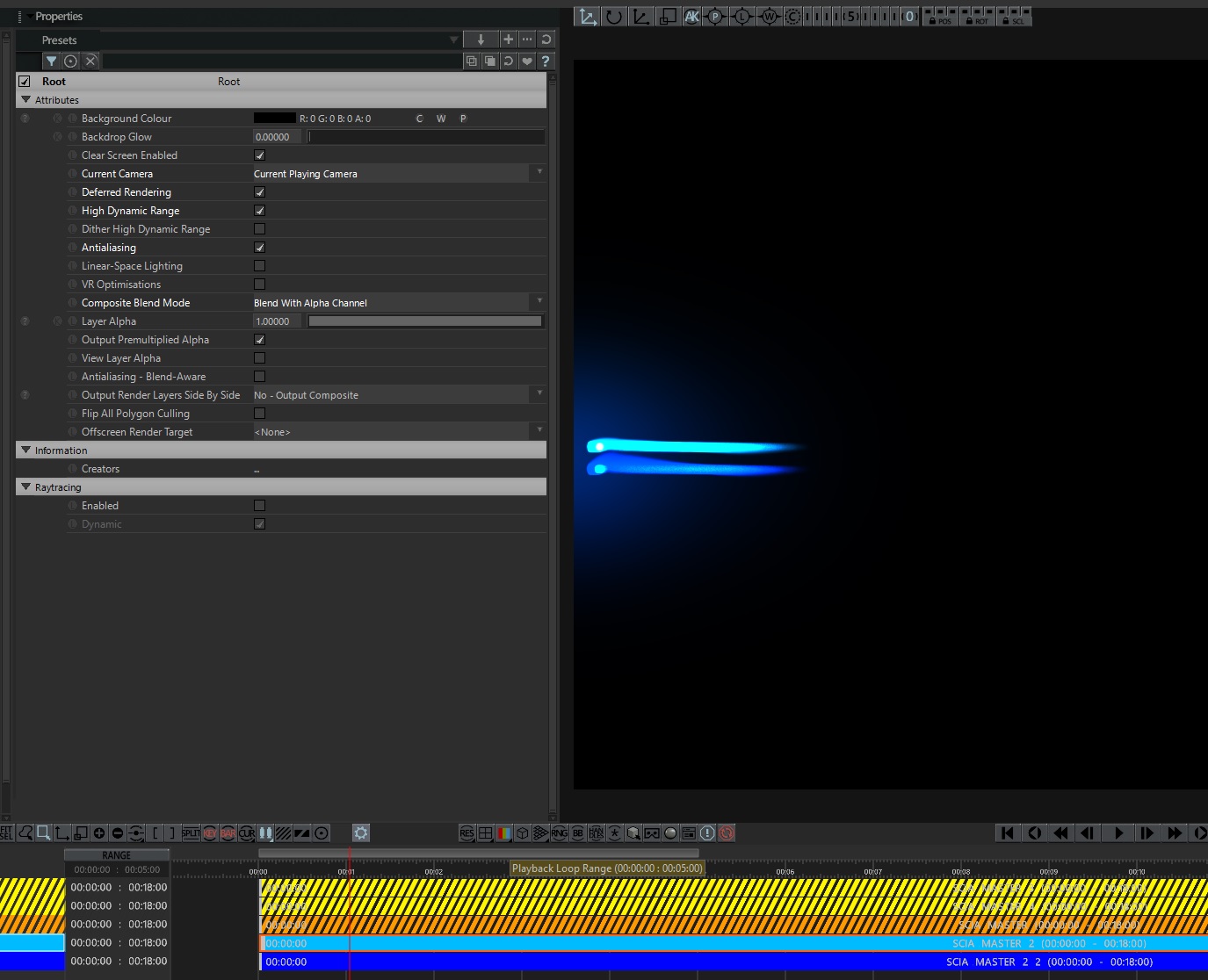

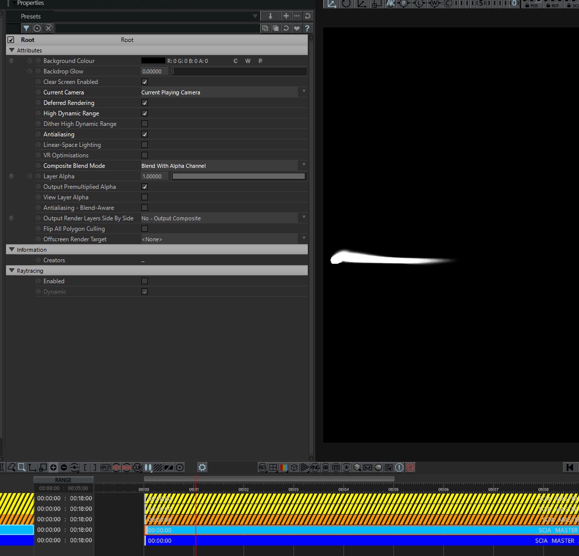

Hello…maybe a very easy question but im tryng to composite five layers using the “Blend with alpha channel” enabled in every layer …every layer has its own alpha but when i render the final alpha i receive is not the sum …i just see one of the 5 alpha exported

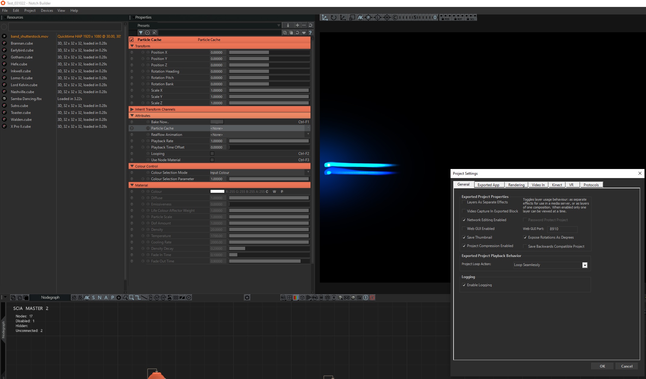

is your project set to layers as separate effects? you may need to disable that.

I think you’re viewing the alpha of just a single layer there - does it happen in an exported video? if so, could you upload the project so we can attempt to investigate it further?
