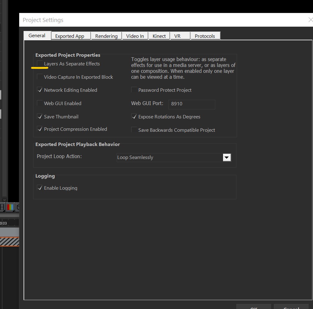

First, make sure that you are rendering all layers at once, so untick Layers As Separate Effects tickbox. Projet > Settings

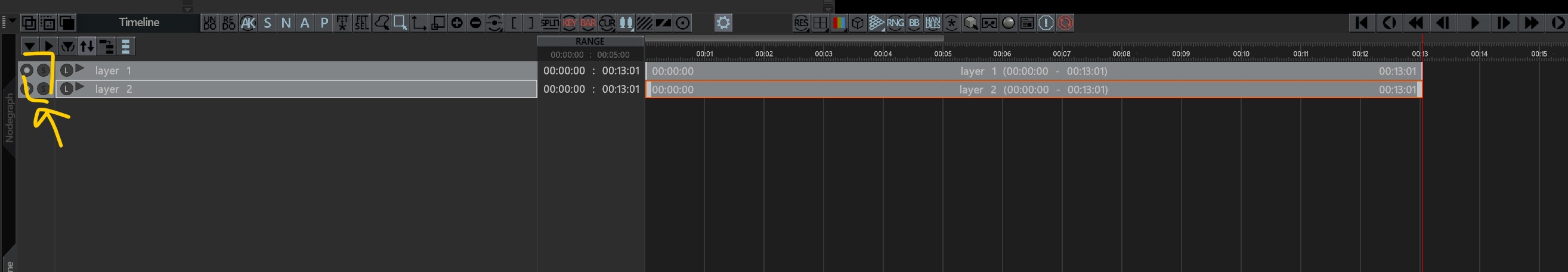

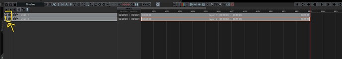

Then make sure that both layers are unsoloed:

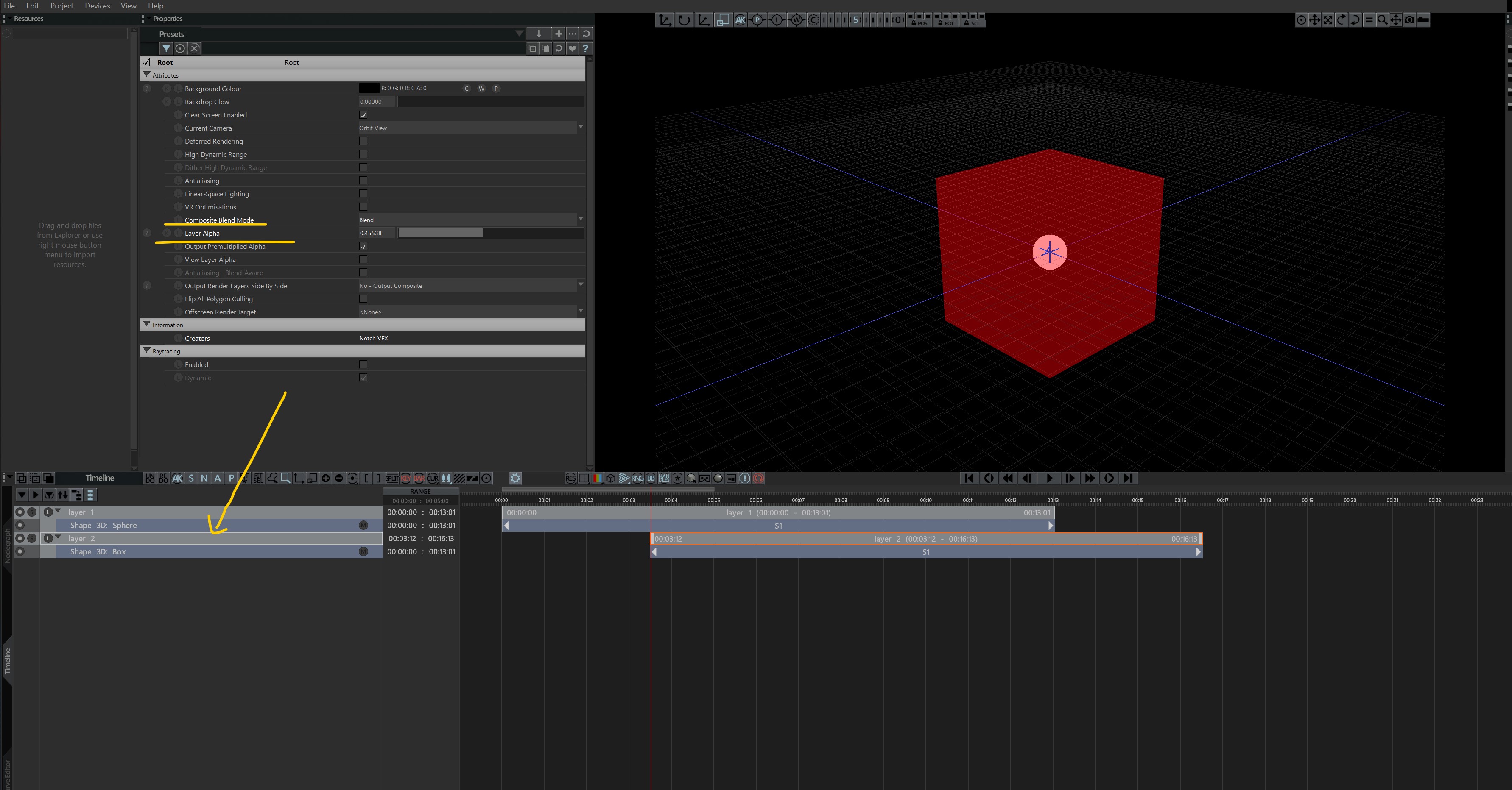

Now you can change composite blend modes of the layers and they will stack as per any other layer based linear video editing software. Just choose Blend from the dropdown menu and use/keyframe Layer Alpha slider to animate the transition
DFX - transition.dfx (13.0 KB)

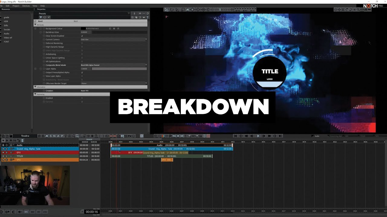

Here is a short breakdown video illustrating timeline basics. It covers obove mentioned technique too:

Oh~!! I didn’t noticed this checkbox “Layers As Separate Effects” !!
that’s why I never found the way to set the alpha of the layer!!
Thank You Armin!!
