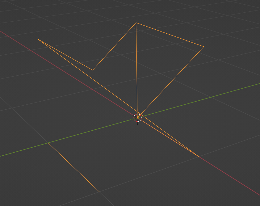

I’m trying to import a simple OBJ file which contains nodes and lines only (no faces).
I understand that having vertex color is not officially supported in OBJs but I can’t see anything on screen (not even the geometry).
Here what it looks like in blender.
What is the best way to import complex splines in Notch?

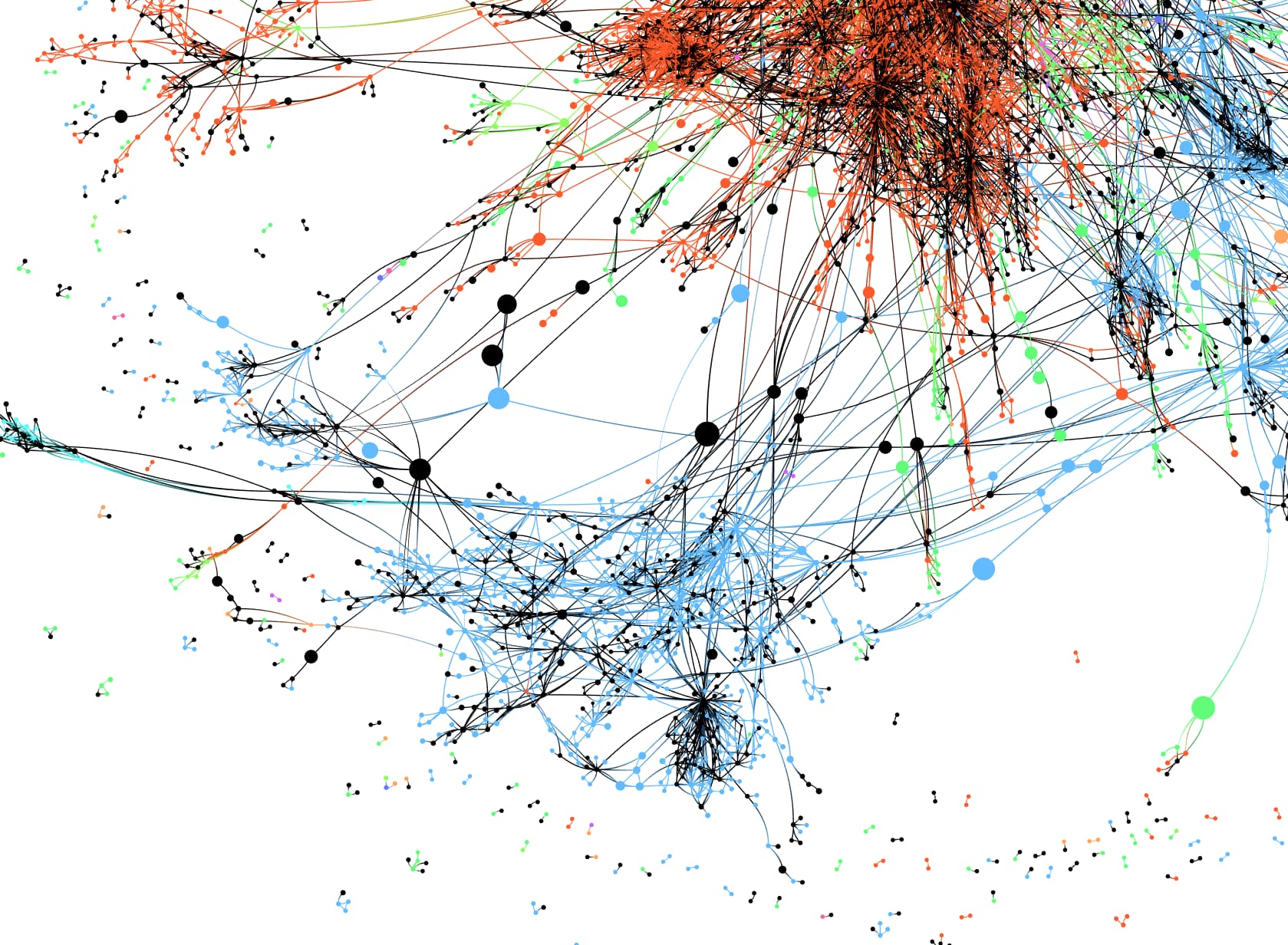

I’m trying to animate a 3D network visualization (it’s like a connected point cloud where the edges are given in an adjacency list) but I can’t find a way to import it into Notch.
I’ve looked at Arrays, CSVs, etc. but to no avail.
This is what I would like to import in Notch (point, lines, colors):

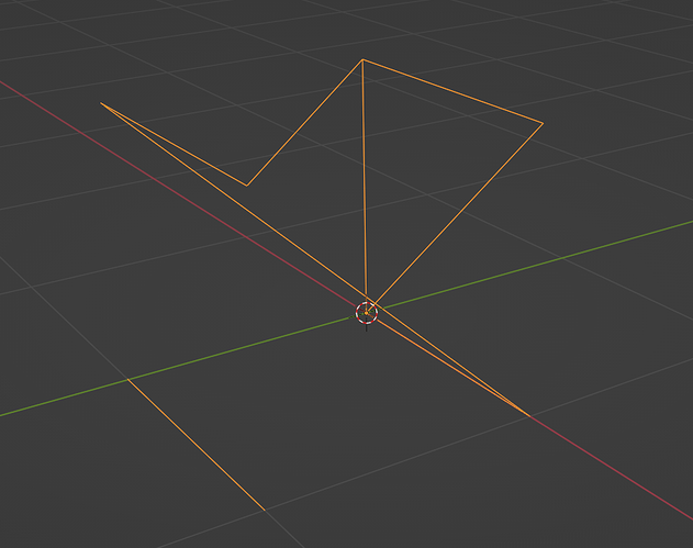

It is not a continuous spline. A graph may have disconnected components. Here is the OBJ file I load into C4D. I can’t get the vertex colors to show (I don’t know the software)…
https://www.dropbox.com/s/nuqlegm2g23lysz/line2.obj?dl=0
Thank you!
It loads into C4D as a 1 continuous spline.
Then saved as C4D and imported to Notch.
line2.dfx (95.0 KB)
Thanks! Unfortunately the original file is not a continuous spline so I guess it’s not really working.
