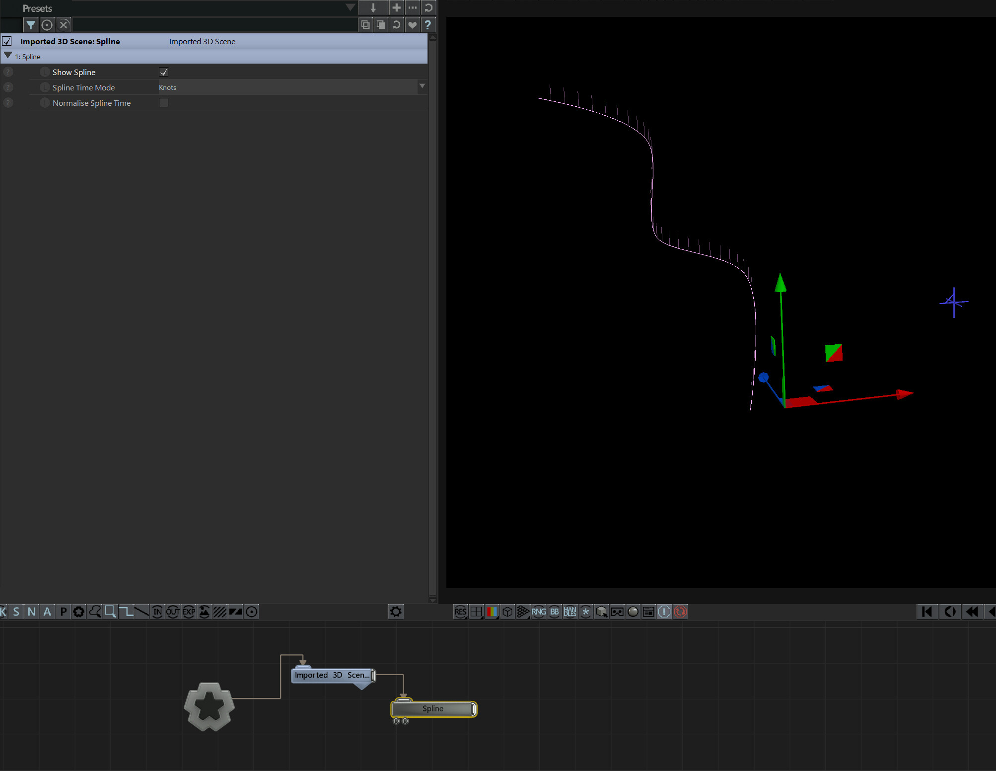

I cant seem to get splines importing into notch from c4d. I’ve looked up many post on this forum and downloaded examples that show the spline working, but when I change over to my C4D file the spline disappears? It Also disappears if I switch back to the spline from the downloaded example?
I’m wondering if there is a setting im missing or perhaps there is something wrong with my C4D setup?
If someone could show me how to set this up in notch that would help me alot.

Seems to load just fine.
Make sure “Show Spline” is checked within the Spline node, within the Imported 3D Scene.
Also make sure you are scaling it down significantly, or try changing the Scene Scale in the Import Options to something like 0.01.
Thanks for testing this for me, much appreciated.
I’ve spoken to support and it appears to be a bug that they have fixed for v1.0
