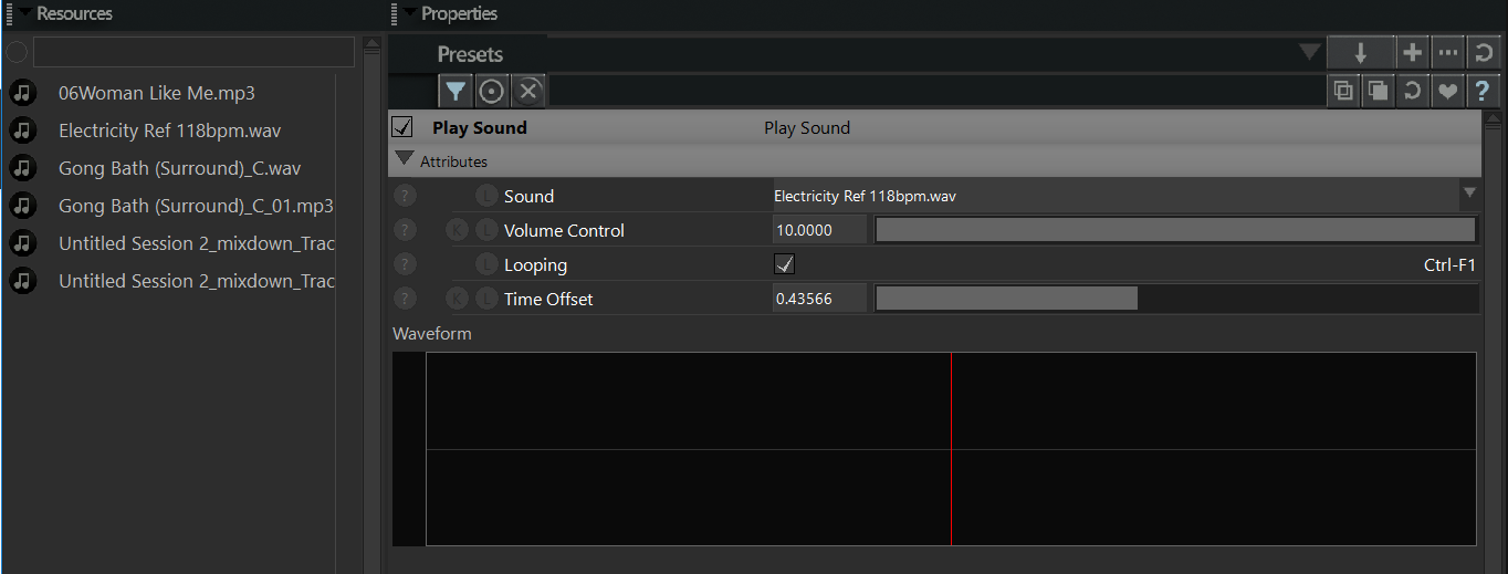

I tried playing a variety of files through play sound node and I am not getting anything - no waveform or sound. Am I missing some fundamental step I have to do before importing/dropping a node and hitting play?

I have tried variety, MP3, WAVs, different bit resolutions etc. Nothing seems to work. Very puzzled, hope it’s not a setting I am missing…

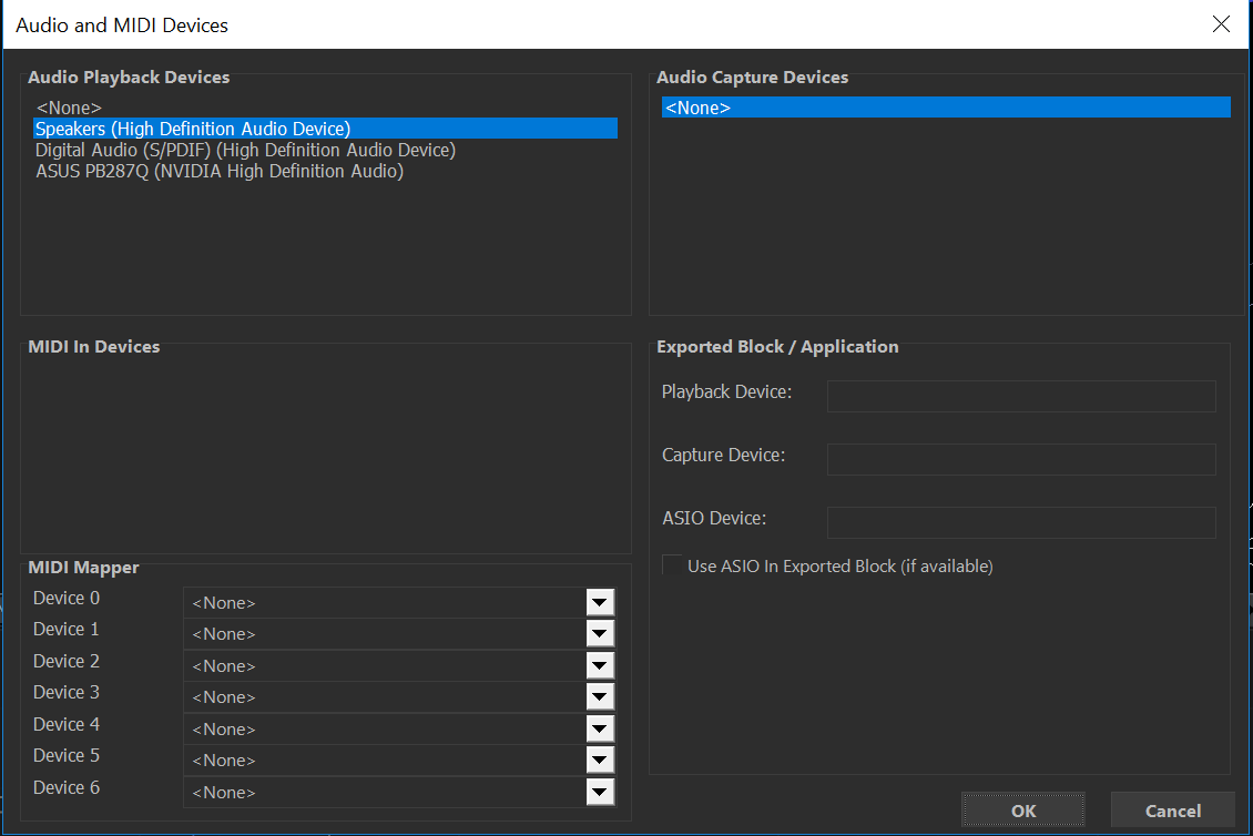

Notch 0.9.21.030 PRO x64, Windows 10 Pro
I have selected the active sound output (screen attached):
And when pressing play, none of the files used (ruling out single file corruption) show waveform or make any sound.

Yes, all of the audio files play fine in AE, PR and VLC with no issues. I have restarted the machine multiple times, creates new projects and nothing. Am I correct in thinking that even if it’s sound card issue, I should still be seeing waveform being generated?
