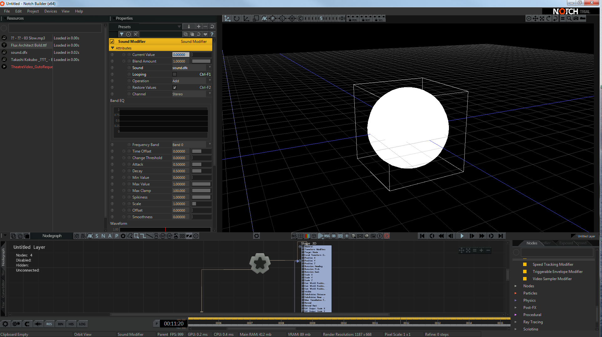

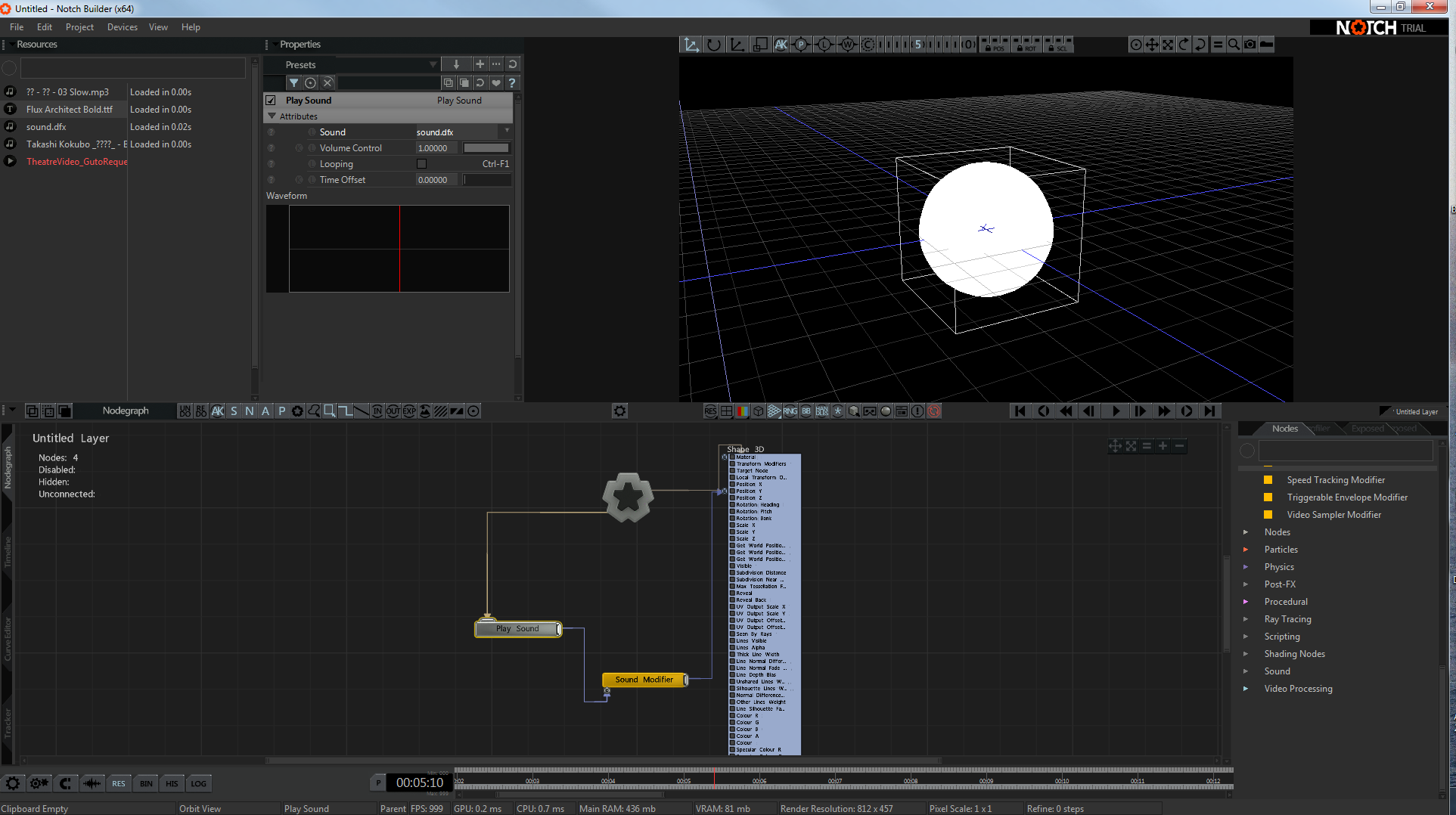

The problem persists, even with that file you sent. I attached two screenshots to show the settings the nodes are set to.
![Notch1|690x386]
It does run on 2 systems i have checked just now.
I see you have sound.dfx as audio resource in your resources window.
Not sure how you managed to bring it in there…
Could you instead double click on the sound.dfx file to open it?
Your file should look like this -
