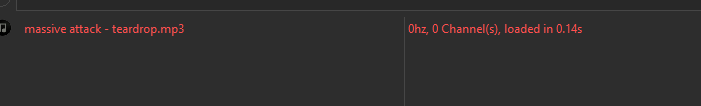

no sound working on my notch. was a few days ago.
some files get imported without the wave. some have the wave but still no sound.
the fft’s are showing 1kb which is wrong.
deleted them and tried again, no luck.
they are all coming in saying 0hz and 0 channels in the resources.

they import with no data. the fft file is 1kb no matter what sound I use.

the issue is the fft being loaded at 1kb. and the resources showing red for the sound file. and resources showing 0hz, 0 channels. This it should not be doing, and this has nothing to do with sound setup, but something to do with the way notch is reading these files.

checking the logs, here’s the issue:
11:08:18 : Unable to open audio stream file: C:\Users\g1\Desktop\Fallen Leaves Instrumental Mix 20171024 1.mp3
11:08:18 : unable to open soundStream: C:\Users\g1\Desktop\Fallen Leaves Instrumental Mix 20171024 1.mp3
11:08:18 : unable to load sound file: C:\Users\g1\Desktop\Fallen Leaves Instrumental Mix 20171024 1.mp3
11:08:18 : unable to decode soundStream. No data.
Following up here - this issue appeared to come down to Permissions issues on the OS level, solved by reformatting the drive. If anyone else does run into an issue this extreme, do get in touch to see if we can identify it, but otherwise this looks very specific to the hardware/software involved.
– Ryan
thanks Ryan for all the help.
I think I’ve isolated it to the new Google Drive. As after the my reformat the problem reappeared.
I moved the files out of drive and it worked. (before format I tried this, but somehow didn’t work).
