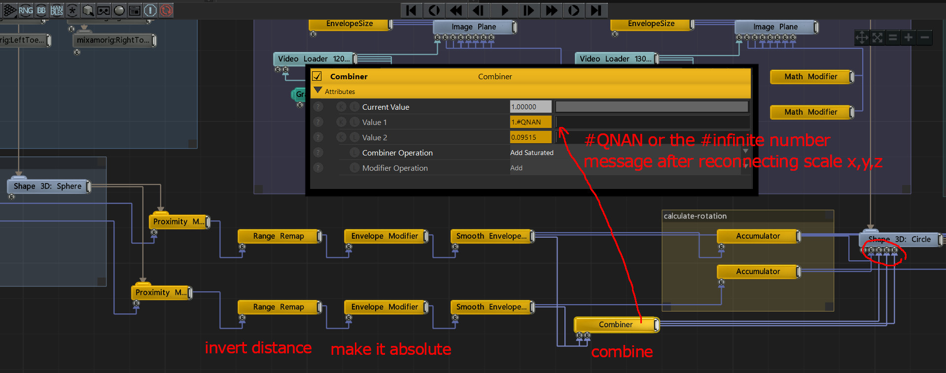

(By the way - in this file - I am trying to calculate the distance between the two hand - in order to scale some geometries in the scene with the help of the proximity modifier - it works but when I reconnect its output - to another transform node (x,y,z) it sometimes give me #qnan or infinity number - maybe I calculating in a wrong way (I try to clamp or wrap it - where it is possible) (I’ve attached a screenshot and the file)

Hey there,
I cant replicate the QNAN thing, although it does look very peculiar. i guess somehow a bad piece of data is being sent down the chain - is the effect still running okay during the process? do you see it happen in other nodes before or after the combiner? do you have a simplified version of this project only showing that issue, in its simplest and most reliable form?

I suppose this weird QNAN things comes from my chain - I measure the distance from the hip to the waving hands - but I have to negate/invert this result - in order to scale up when it is further away from the center point - I couldn’t managed to do it with the envelop modifier (invert) - so I using the range remap - but it was still not OK - so one more envelop - to turn the numbers into absolute numbers - then it worked - but I think this is the weak-point, if I could just simply negate with one modifier I won’t get any further trouble. I got this error when I connect it for example to a new 3d geo’s transform. Ok, I will try to make it more simple.
