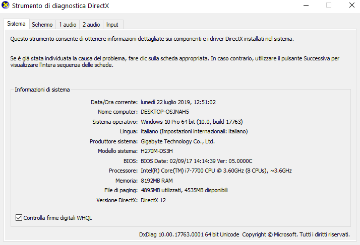

Hi everyone, I have just downloaded the trial version of Notch, as soon as I open it this error appears and if I try to open any project the program closes. How can I solve it? these are the features of my pc:

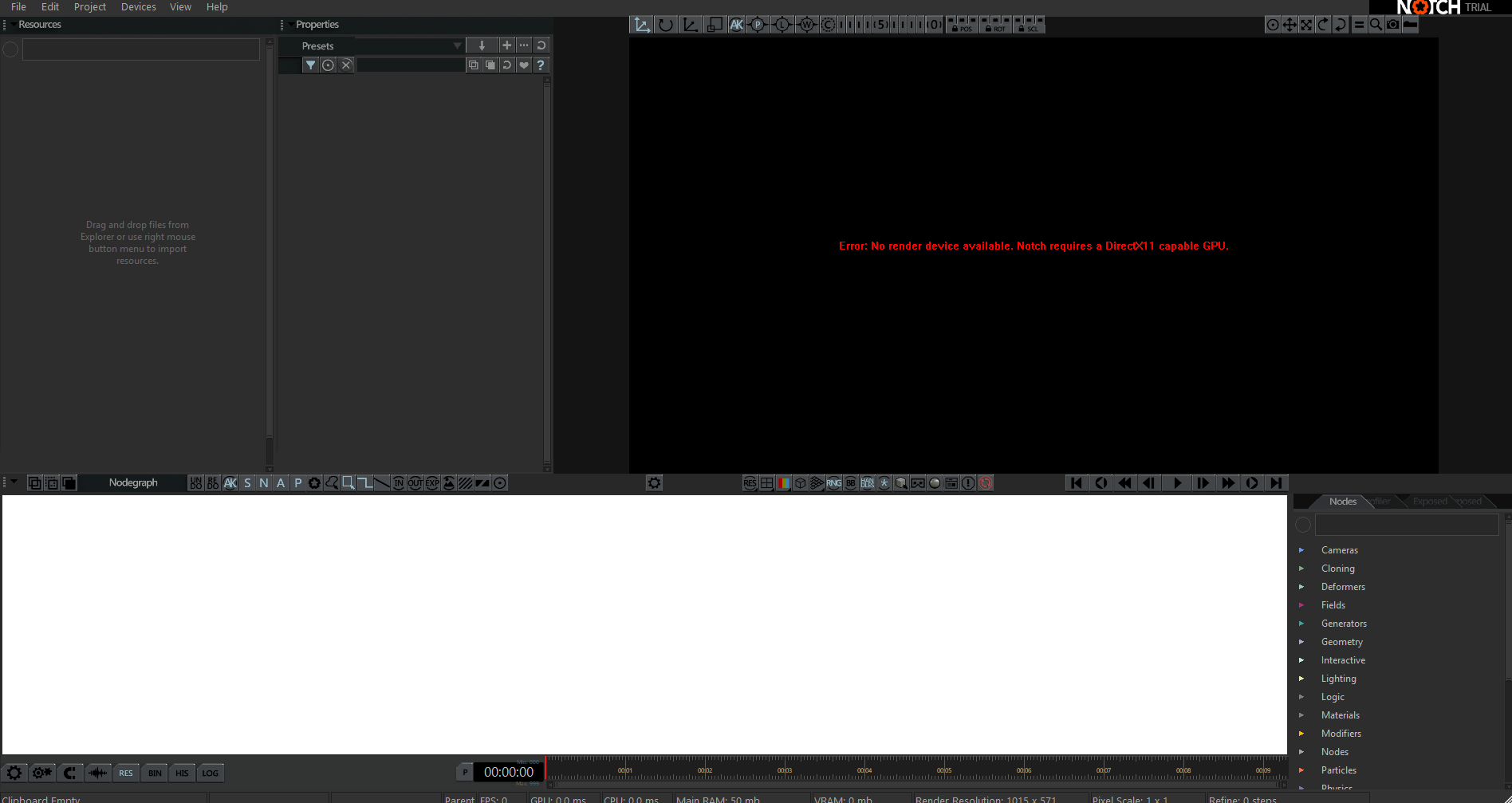

Hi there,
Did you forget to attach a screenshot of the actual error?
Regards,
Tom
Cattura
Hi there,
This issue was resolved. You had an install of Duet Display installed which can cause issues running Notch. See http://manual.notch.one/0.9.22/en/topic/faq-issues-starting-notch
Regards,
Tom
