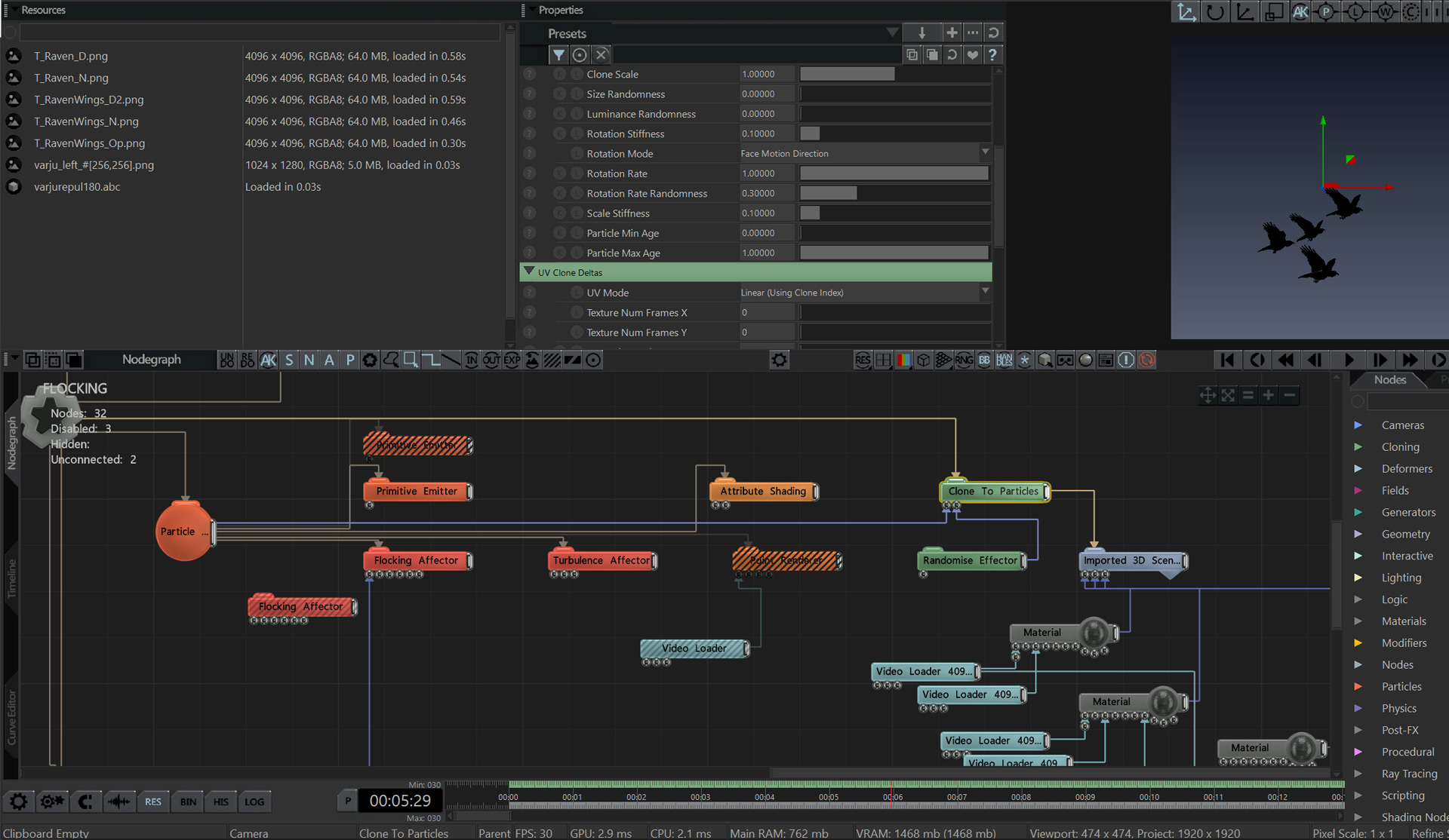

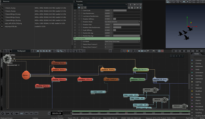

Hi, it seems I always ask questions about ‘time-shifting’ topic,
but is there any solution to time-shift an .obj sequence or an animated .abc file (20 frames loop)
with clone to particle?
(as a tile-sheet feature with the point renderer works, but this time with animated .obj sequence or .abc?)
I have a flocking setup where I would like to use a fly-cycle starting when the particle born or with random starting frame. Mesh renderer with animated obj is not working. I have to use clone to particle, but then I couldn’t change or randomize the starting frame of the loop, all crows doing the same movement, I would like to shift them or randomize the starting frame.
Any idea would be appreciated!
Thanks in advance!
Ok, Ryan answered almost the same question almost a year ago, but it is still wound be nice to achieve…

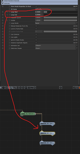

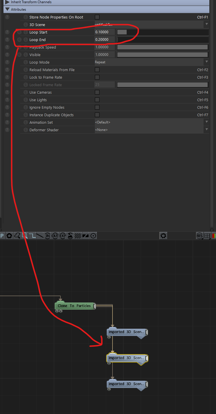

If you clone several birds and offset the loop start and loop end points of each bird
you should achieve a randomized flock of flapping birds.
