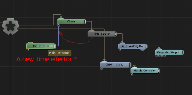

Hi, It would be nice to have an option to time-shift animated clones with the time-stretch node - Is there any possibilities? Or a proper way to time-shift animated clones in time?
Or this would be a new effector category for time-delay - time stretch effects?
Is there already a solution for time-shifting incoming live camera feed (like in touch designer with the buffer/puffer methods?) or pre-animated objects (like animated .fbx or .abc with clones or even pre-animated object directly from the notch timeline?)
I’ve attached a screenshot - about the idea,
and Here I also wanted to ask - how the morph deformer works - because there are nothing about it in the documentation - and perhaps time-stretch node with a morph deformer could also do the trick?
Many thanks in advance,
Cheers,
Ivo

Hey There,
Yes this is something we have thought about a few times in various ways, sadly its not quite as simple as you’d think. The cloner nodes rely on every clone being an instance, or an exact copy of the original mesh. This means for nodes with animations, they will always have the same time for each clone as they copy from the same animated source. This is also why you can’t clone lights, or other arbitrary nodes- they can’t be instanced like geometry can. the main pro of instancing is that its super efficient - you can create 1000s of clones and they barely impact the GPU, copying nodes would lose this benefit.
To make this work, we’d need to totally rewrite the cloner system to add support for copying objects, and while we do want to look into a solution for this in the future its not on any near term plans.
On the morph controller - that node allows controls for blend shapes, which also wouldn’t work for this solution.
Thanks,
Ryan
