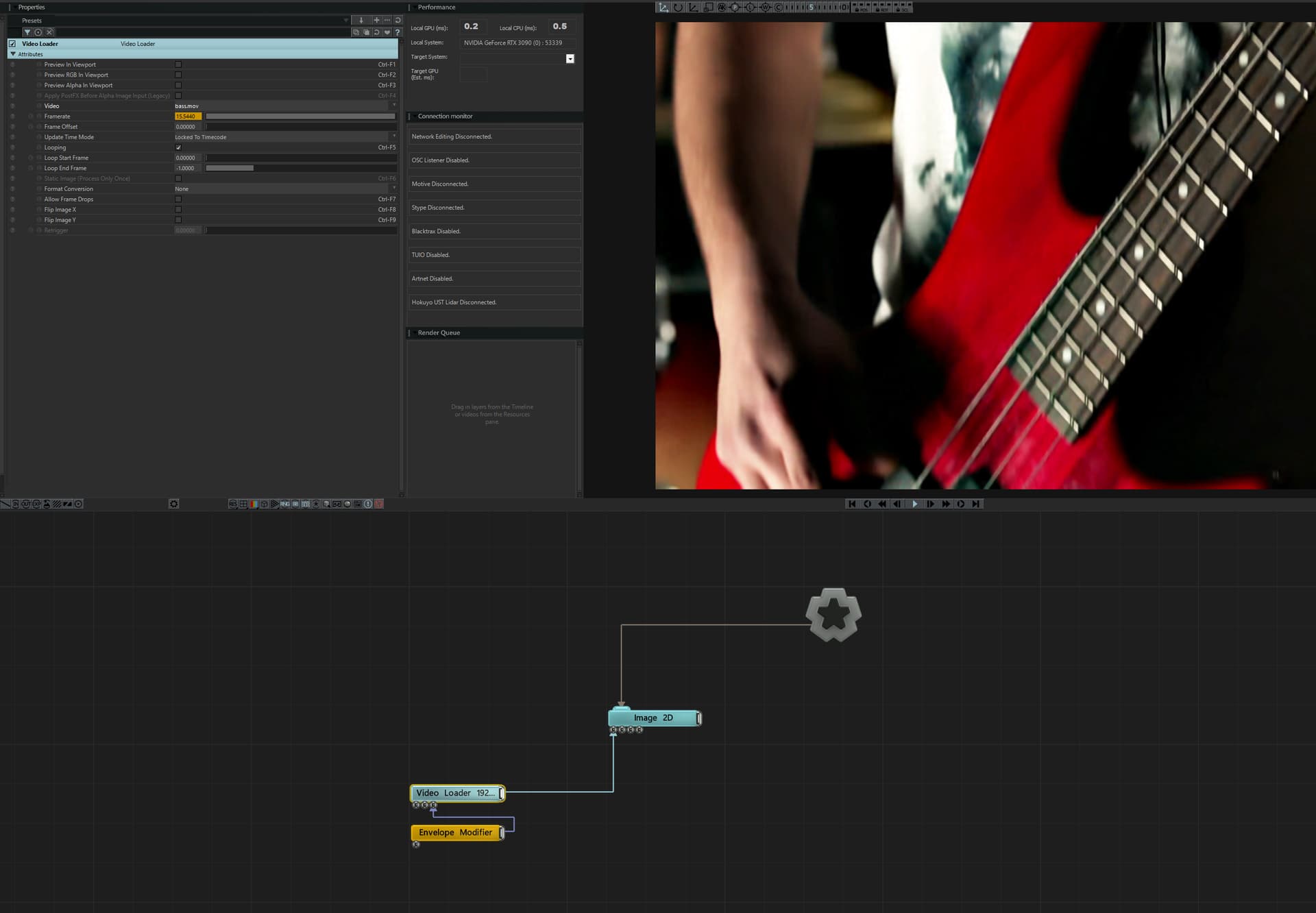

Slowing down footage essentially means you are reducing the frame rate.
To do that I would hook up an envelope modifier set to multiply function and connect that to the frame rate of the video loader. This is how I slow down my footage inside of notch.

yep. that’s what i was looking for.
thx
