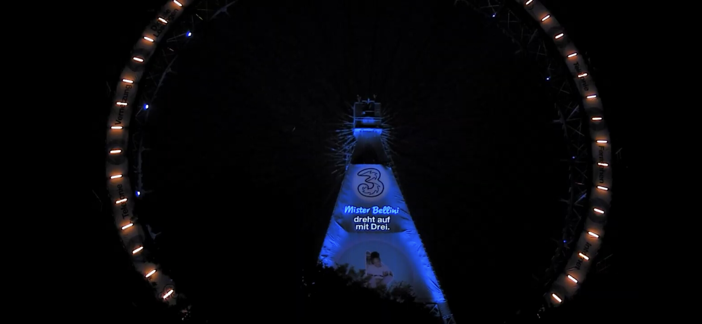

This project runs as a projection on the “Wiener Riesenrad”. People can send their names or messages through a webinterface which processes it into an rss format xml. Due to not having a trigger input on the rss feed nodes the rss update rate is quite high unnecessarily.
