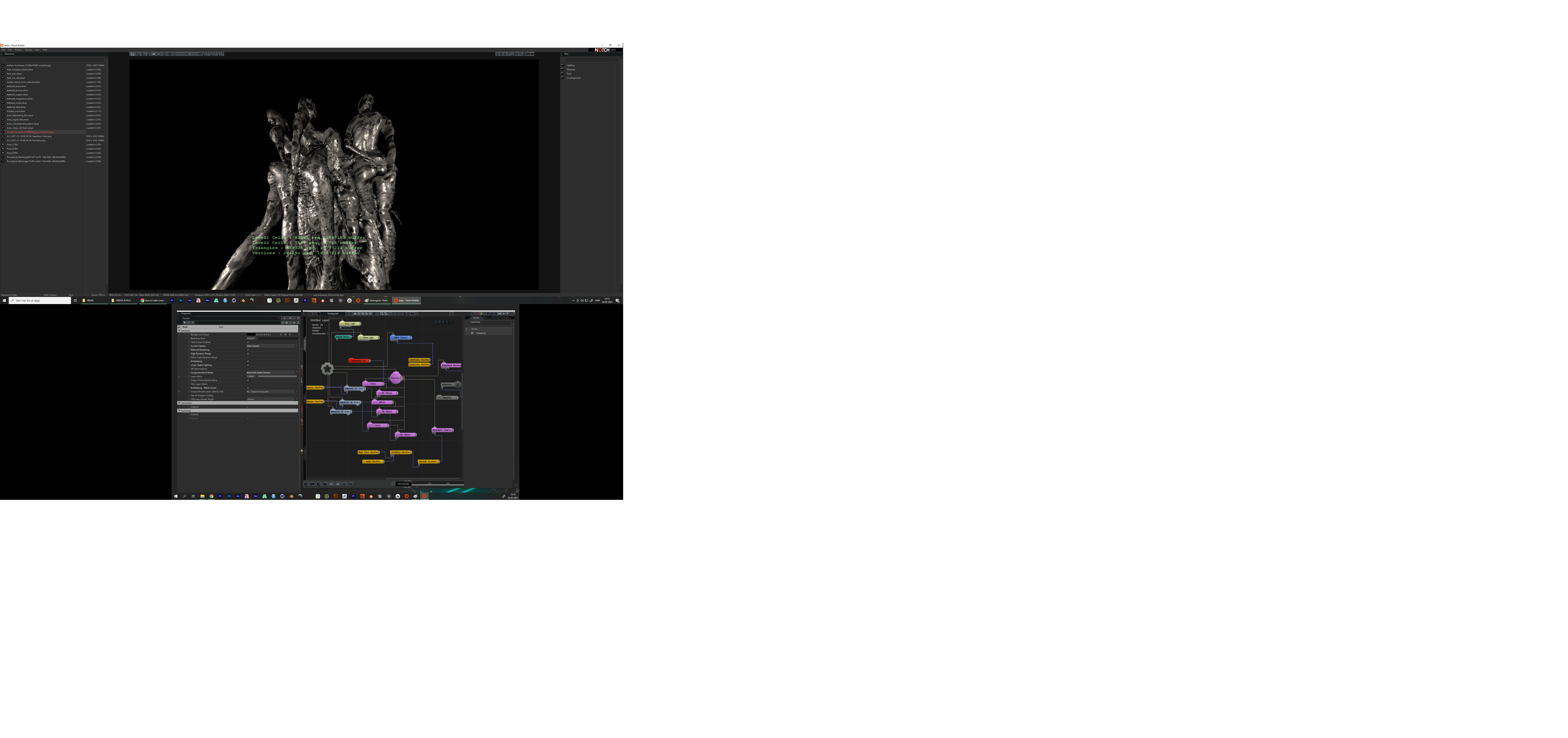

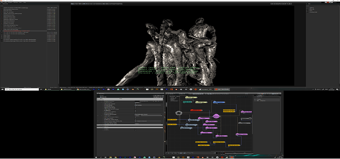

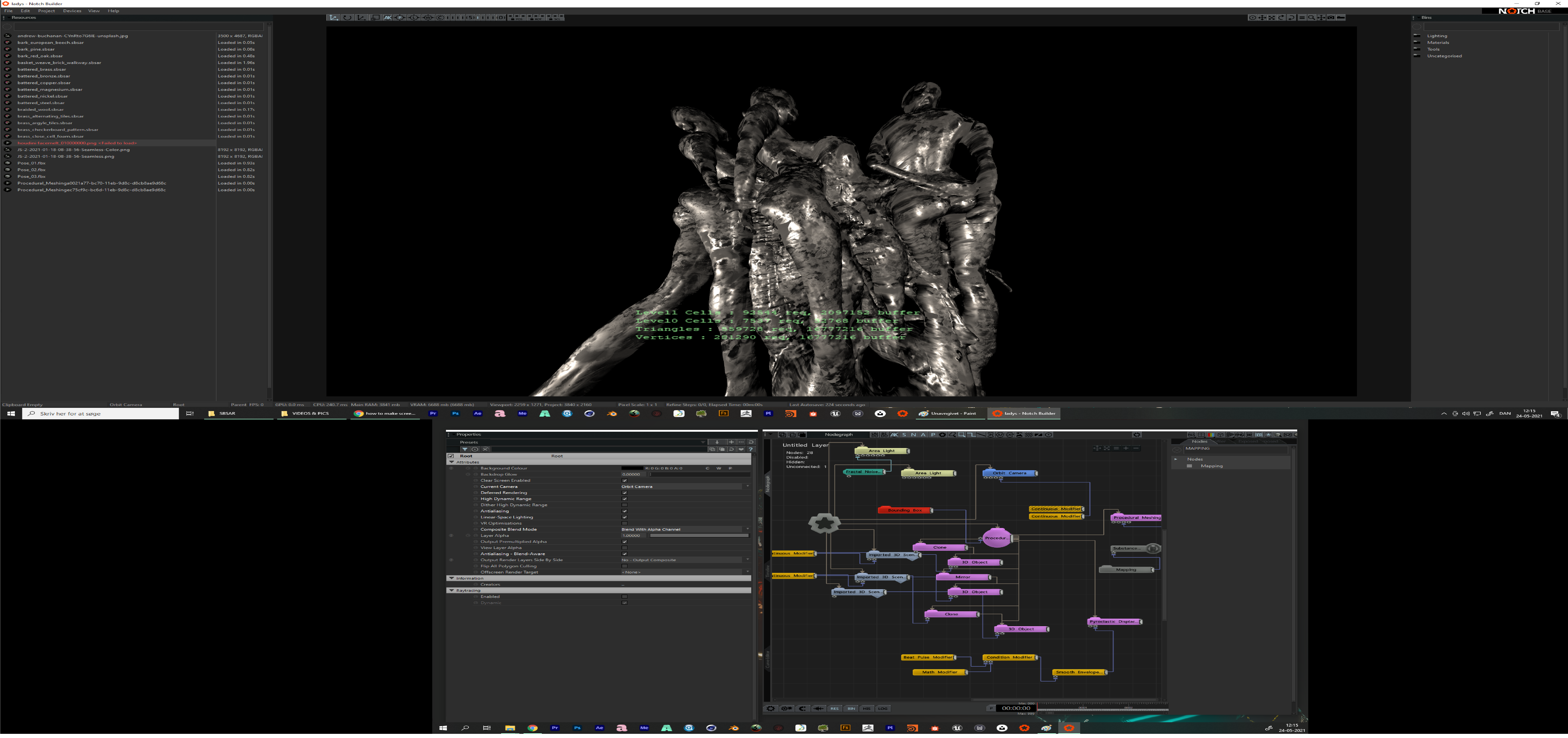

I have been importing png seq fine for half a year then a couple of days ago
I cant import?
It just says failed to load ??
