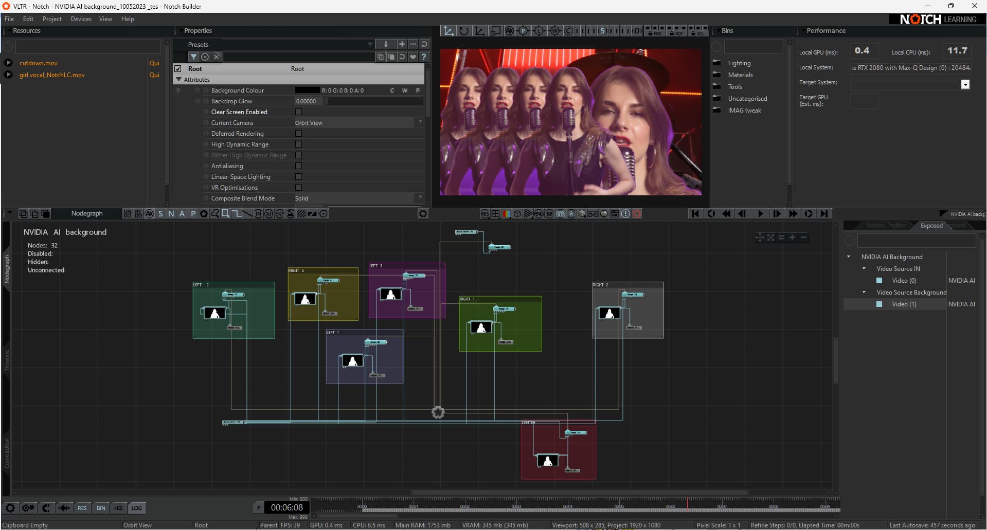

Hello there, i use NVIDIA virtual background for my nodes, i’m tryin to export block to SMODE media server, if I use only one node NVIDIAvirtualbackground it’s work on SMODE layer, but if i duplicate the NVIDIAbackground on Notch it’s not working on SMODE, file cannot import on SMODE layer…
u guys know what happened with duplicate NVIDIA virtual background nodes??

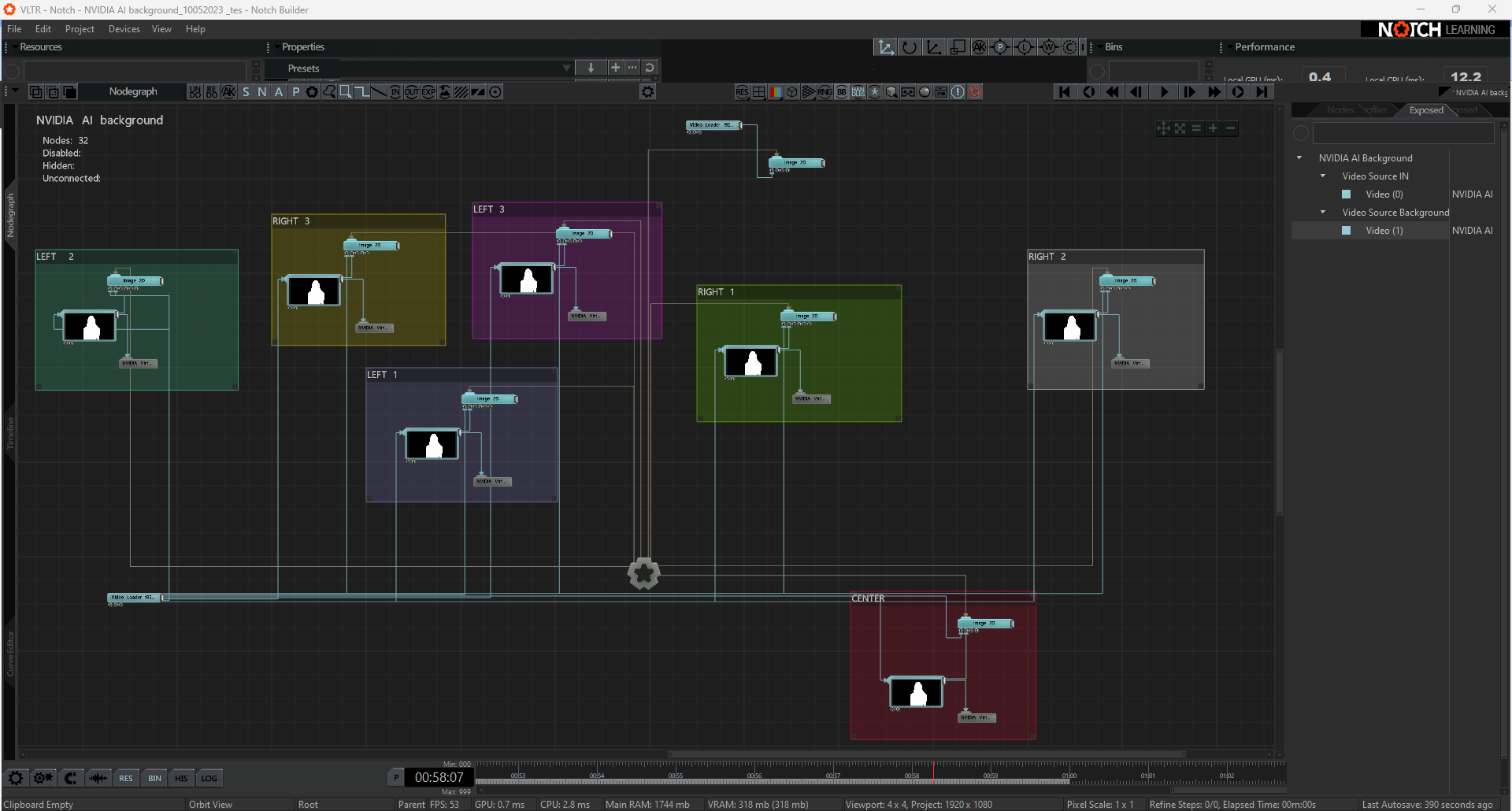

Can you just use one video null with the virtual background and just pipe that into all your image 2d’s?
It looks like you are inputting the same signal into all the image 2d’s. Just use the same signal for all the image 2d’s
yes bro, correct, it’s work well …thank you!
