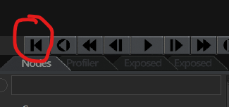

Jump to start to Layer
Hello
I am creating an interactive installation, where the user can use as long as he likes.
For every new user, I need to “clean the screen”
By now I have discovered that I can “clear the screen” using the button: jump to start to Layer
(I don’t know if there is another option possibility)
I’m using a Web API as an interface, where I would like to add the button “clear the screen”
Any recommendations?

Okay, so the reason hitting home effectively clears the screen is because it doesn’t just jump to the start of the layer, it also resets the simulations for every node in the scene - so just jumping the time back to that start with a hotkey wont be enough.
As for alternatives… trickier question. We’ve internally discussed adding reset properties for simulation nodes, but that wont be coming in a patch release. I think there’s probably a few avenues which may work, but it will depend on your scene setup. Most likely you’ll need to use a combination of Javascript and kill box nodes to remove everything in the scene, and reset them to their original locations. @torbjornfernstrom 's suggestion to fade to black between scenes is probably a good idea to hide some of the change over.
