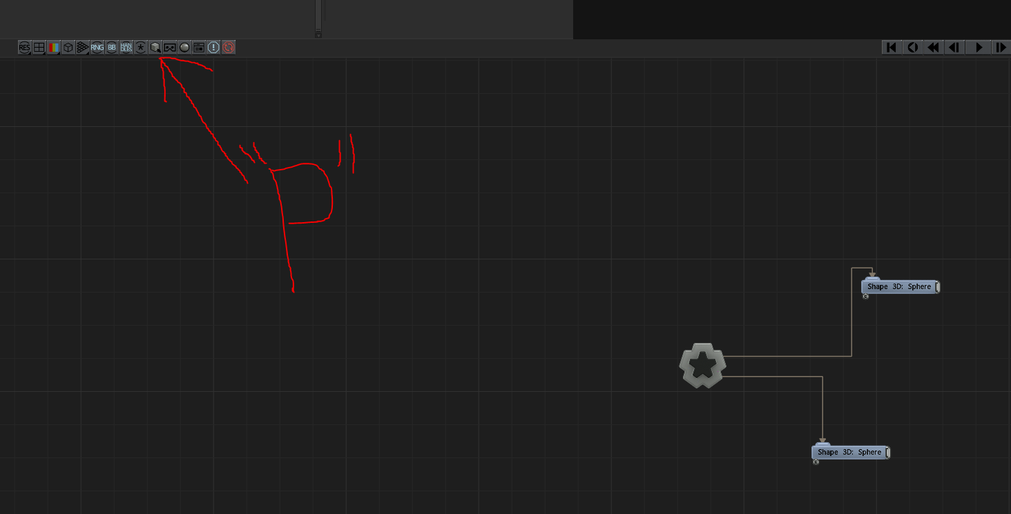

As the title says, can you click on a specific object in the viewport to move it or find it in the node graph? It’s a simple problem, but I’ve been ripping my head around this for days. There is a problem that there are too many objects that make up the scene, and it is not possible to organize them in the node graph.

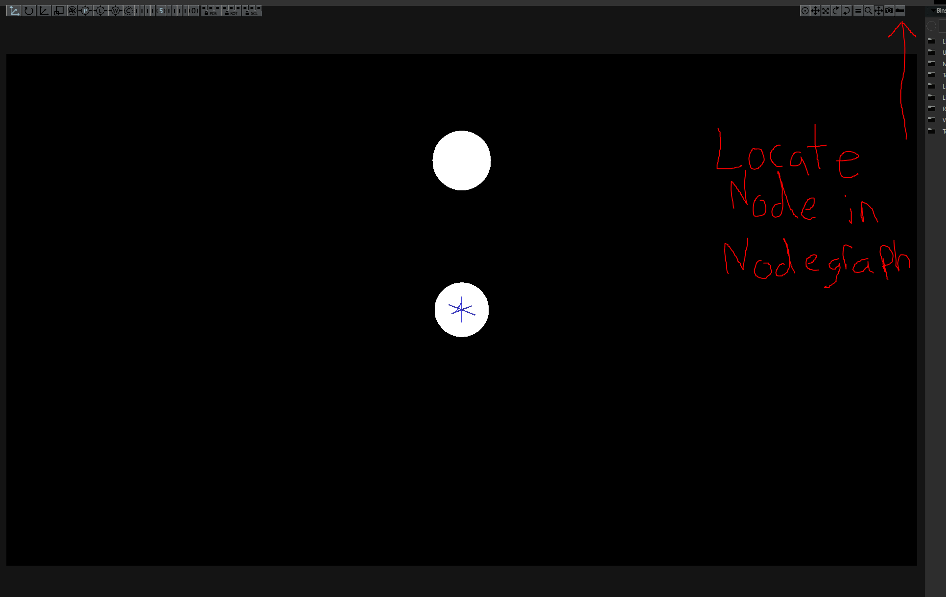

You can select objects in your scene by pressing “P” on the keyboard and then clicking the object in the viewport. Once you have your object selected there is another button that is top right of the viewport called “Locate Current Node in Nodegraph”, this will center your view on the selected node.
