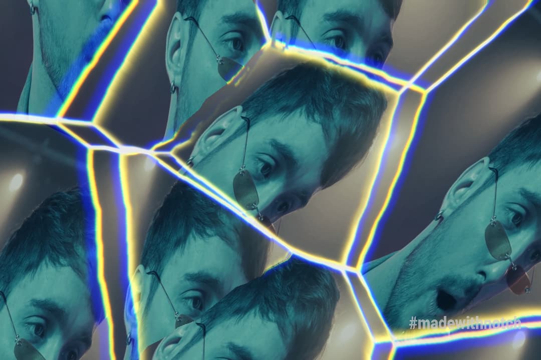

I’m trying to create a broken mirror effect like this one:
I’ve gotten something like it using voronoi post process, but that not really what I’m going for.

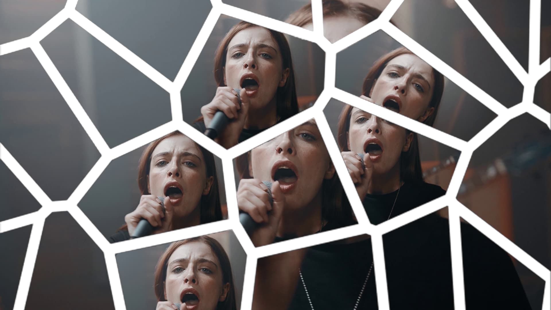

Played around a bit with the effect and got the lines between working as well using 3d outliner post-fx:
