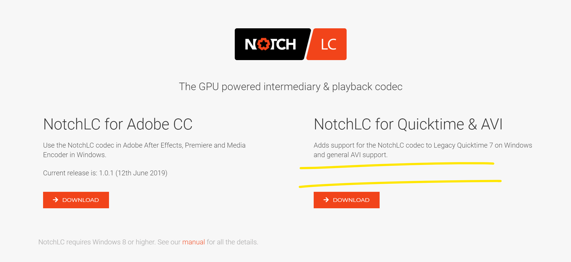

Do you have NotchLC for Qiucktime & AVI installed?

I do have the Quicktime & AVI support application installed.

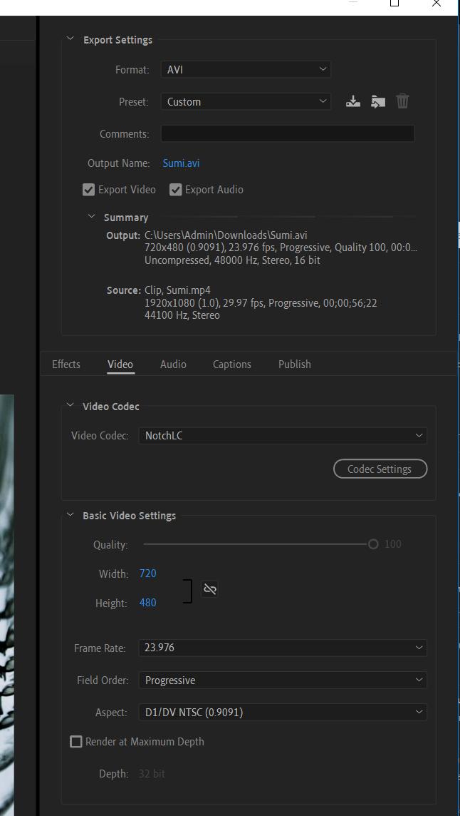

That sounds weird as it should just show up like any codec you might install. Here it is in media encoder.
As for difference between AVI vs MOV, its more about what the rest of your pipeline and what it can take.

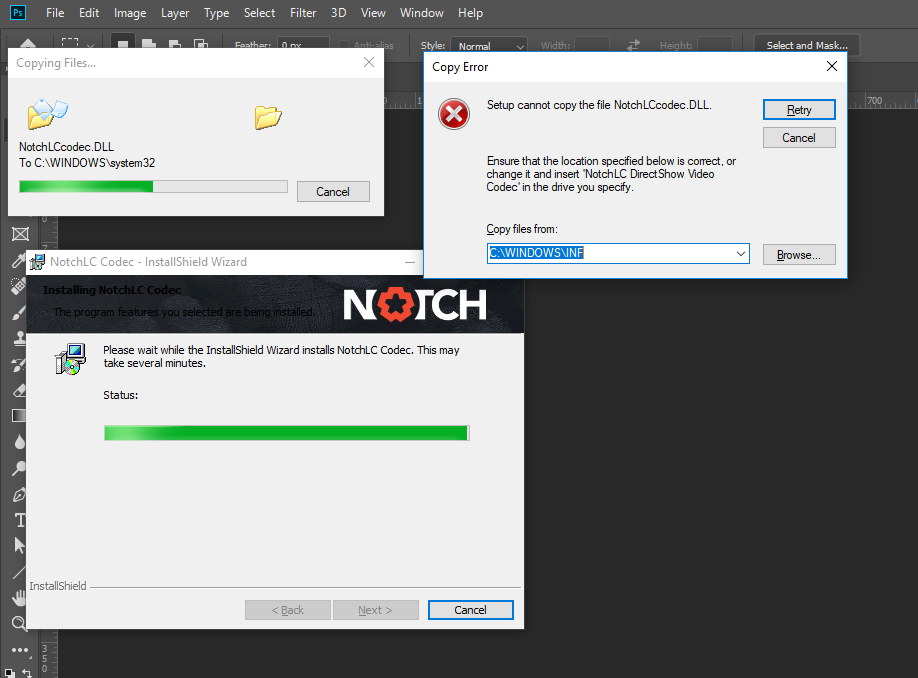

On the workstation and enterprise build I get the following error during install.
I point it at windows\system32 which has the file in question and it works but that seems concerning.
Any additional suggestions?
So I was digging into the installer a little bit and it looks like there is an error where it is skipping adding some registry keys.
notably it didn’t add
HKLM,"SOFTWARE\Microsoft\Windows NT\CurrentVersion\drivers.desc",NotchLCcodec.dll,,"NotchLC video codec" HKLM,"SOFTWARE\Microsoft\Windows NT\CurrentVersion\Drivers32","VIDC.NLC1",,"NotchLCcodec.dll"
I added these entries and the NotchLC option showed up in the AVI codec options. I did an encode and it seemed to work. It seems like something might be amiss in the installer code.

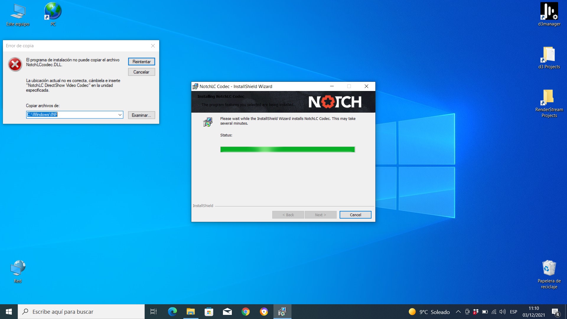

I have had the same problem with my recent windows 11 computer with MPEG Streamclip and also with disguise D3.
Could someone tell me if the problem has been solved or if not how to attach the solution to the registry: Isaac Gierard.
Thank you so much
Windows 11 is currently not on our official supported OS list, seeing at it was jut very recently released.
I format, I install windows 10 and it gives me this error …
Could you send this issue into support so we can look at it more closely? Just to avoid clogging up this post.
