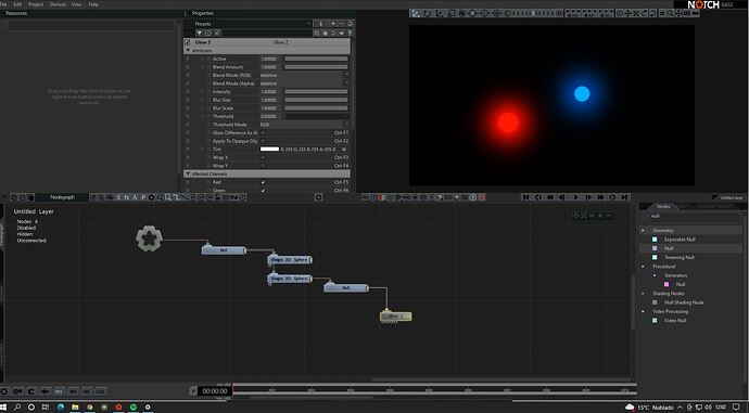

This is probably a very stupid question, but as a beginer I’m having some trouble understading how nodes are connected inside Notch and the “video” signal workflow. For instance, I want to add and FX to a certain 3D object, but the FX is applied to all the objects.
Any tips?

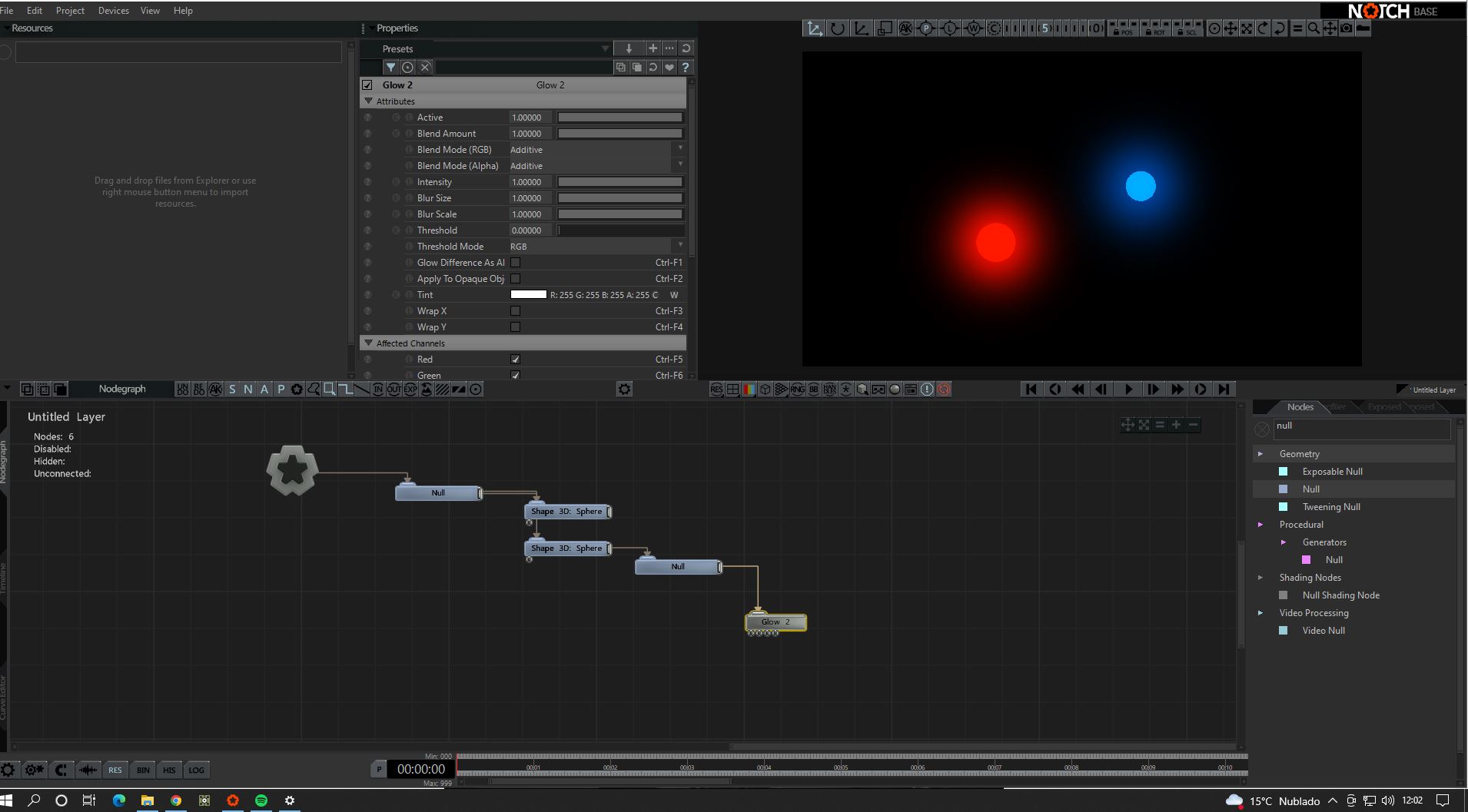

One more question @ryan.barth … What happens if the Fx is not a glow, and is, for example, a datamosh? This node doesn’t have an input for “affected objects” …
Not all post-fx support that workflow, for the others you can use render layers.
