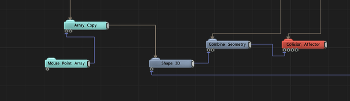

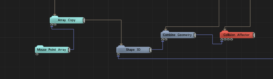

In this instance, I feel it would make more sense to use the mouse picker node rather than the mouse picker array node setup you are working with. (mouse picker connected to root, shape 3d child of the mouse picker.) this will keep the object visible with no mouse click.
Couple different options you could use here, the mouse picker is a reasonable option too.
Personally, I would just add a Combine Geometry between the Shape 3D and the collision affector.
