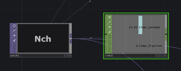

Derivative informs me that Notch Blocks don’t expose the duration/length of said block to media servers:
Why is this, and are there any plans to implement in the future? Thanks in advance.

I can confirm- using an Info CHOP on a Notch Block doesn’t report length.
Yip, you’re right. Blocks don’t report track length to the host. It’s not quite as simple as you’d think as there are multiple modes for blocks to be in and depending on the mode you’d need to have a block-wide track length or per layer.
That said, it is something that is on our radar.
