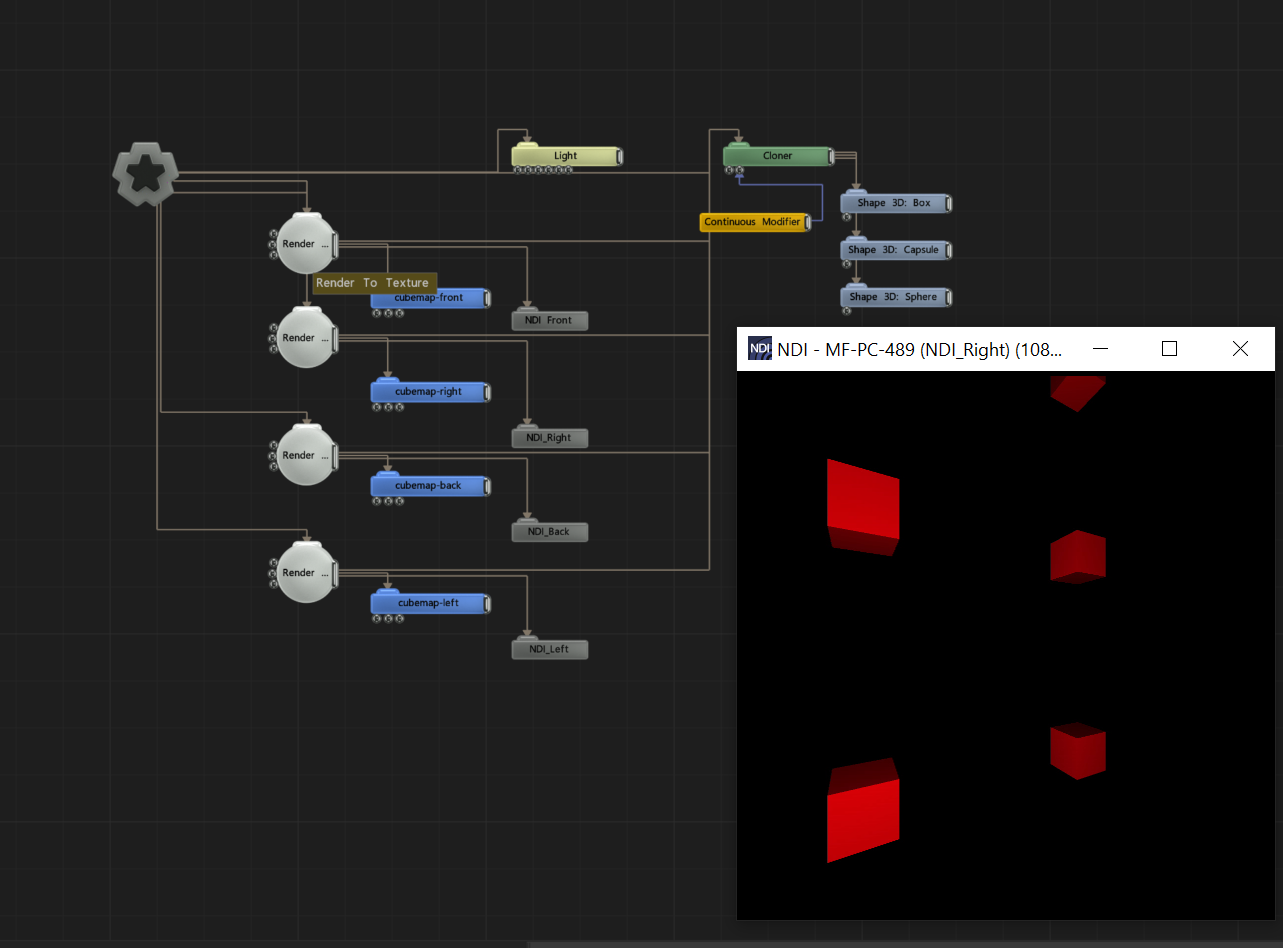

Force your camera setup render with a “Render to Texture node” you can adjust the resolution of the camera directly in the node without tweaking the render resolution in your root.
