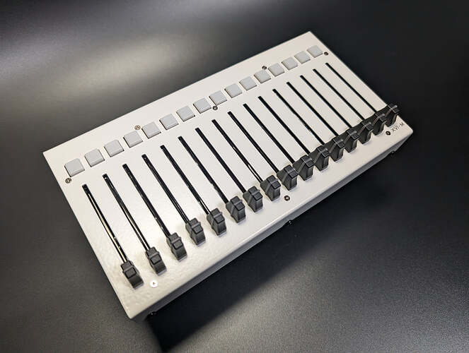

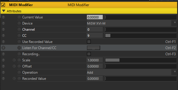

Hi, I’ve recently purchased a midi fader bank to control notch. I’m having trouble getting it to work. When I use the midi modifier and listen for channel/CC it finds a CC value but does not update the slider value. The device is a XVI-M…

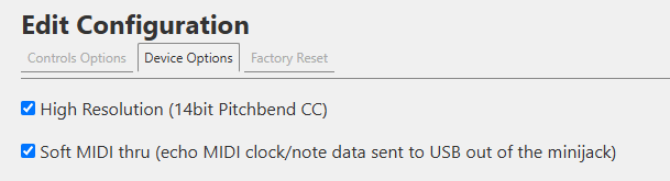

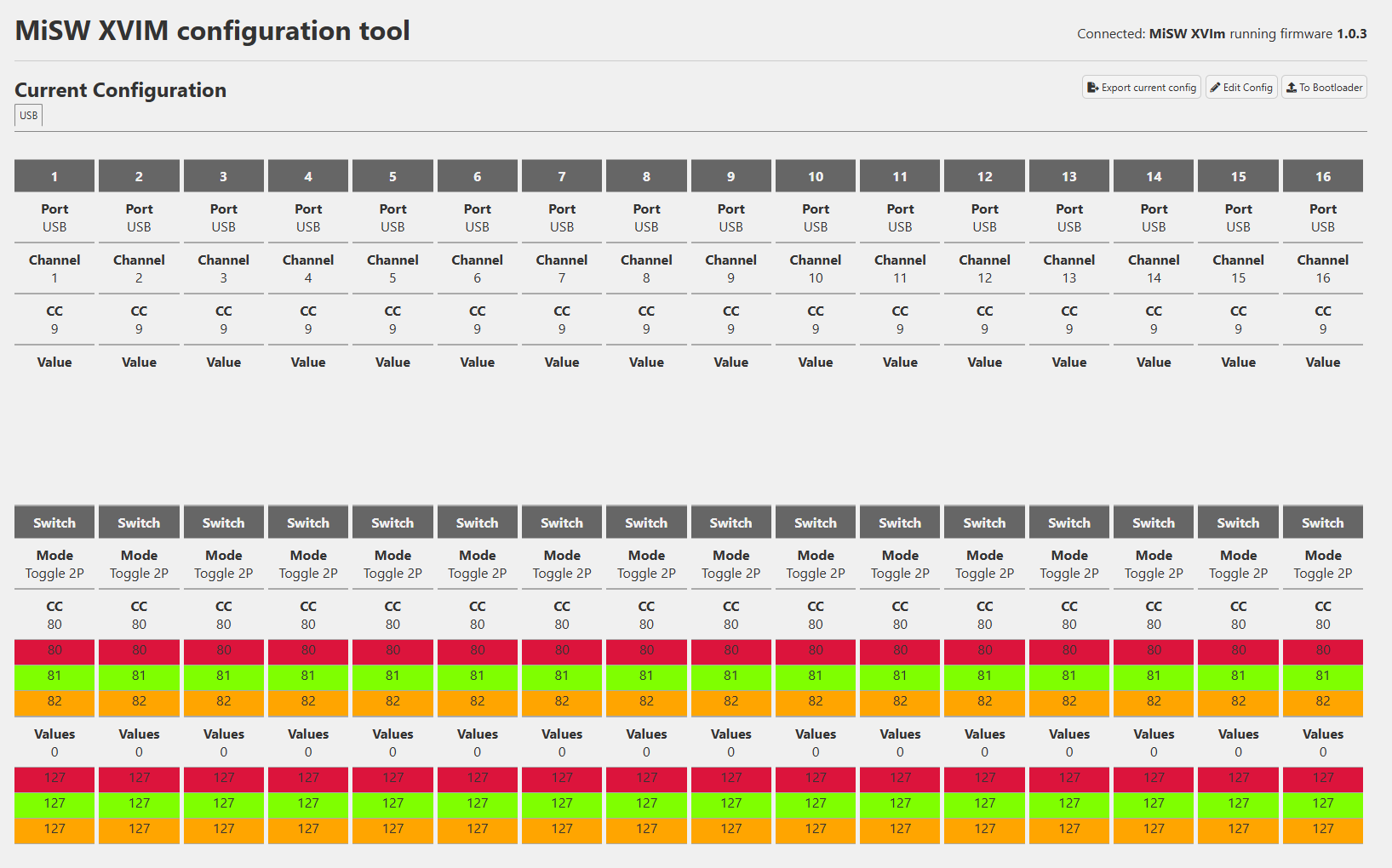

The parameters of the midi are editable but not sure what notch is looking for. I’ve attached screenshots of the parameters…
…it seems to find the correct channel when I listen for CC but it returns no value when I use the sliders? Anyone had this problem?
For anyone interested Ive got it to work. The value was not showing until it was connected to a parameter. When connected it worked
