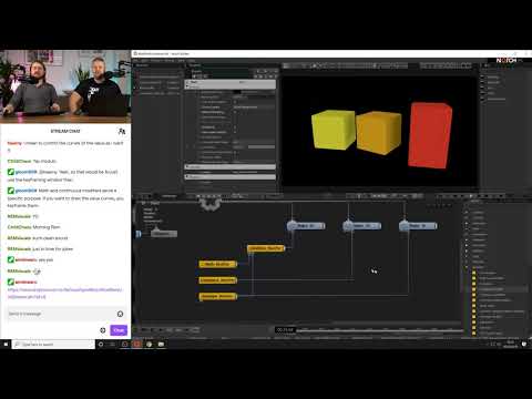

So my approach was just wrong, the best way is to work with modifiers that constantly modify the time in each node (or fbx animation) and just forget about the main timeline.
Best explanation I could find was in this livestream at 38:25 using Time stretch node:
