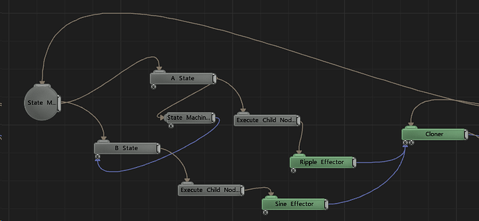

The excute child doesnt work with Effector either it seems! I was hoping to make a generic block with some different effects to switch between, and save some ticks while particular ones are not in use. Maybe a state machine will do it…
Well that doesnt seem to work, both states are active!
Yeah, I abandoned the inbuilt state machine pretty early on and wrote my own in JavaScript. I also noticed it could not enable/disable certain nodes. With some intensive nodes you can input a bounding box, what I have been doing is making the box very small when I’m not using the effect, this helps things like the Flocking Particle Affector from sucking up resources. If you’re lucky changing the radius of the effect you are working with might have the same effect.
