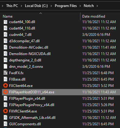

One way to narrow down the problem would be to run the block on FXPlayer, if the content looks normal on FXPlayer then I would say it is something in your disguise project.
You can find FXPlayer in the Notch folder

Thanks Mark, this was a big help. Looks like I had a Glow that was too strong on the Disguise server but looked normal on my PC.
