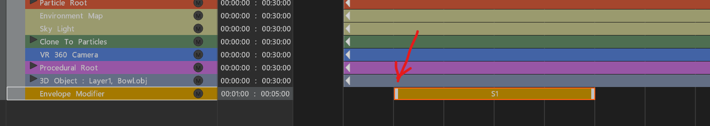

As for triggering it at a certain point: You could have an envelope with a value of 1 and in the time line you could position its layer at a specific point and effectively it would trigger wherever you place it.

This is really helpful thanks for the detailed explanation. I think this should work fine.
