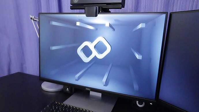

I had a go at it a few months back. The best I could do was just with camera rotations and translations based on nvidia face tracker. Basically make the scene rotate with your face, and as it rotates, translate the scene back to the center of the screen. It worked ok, but not quite convincing. I’m still looking out for other options.
https://www.facebook.com/1121340647/videos/595534888109220/
