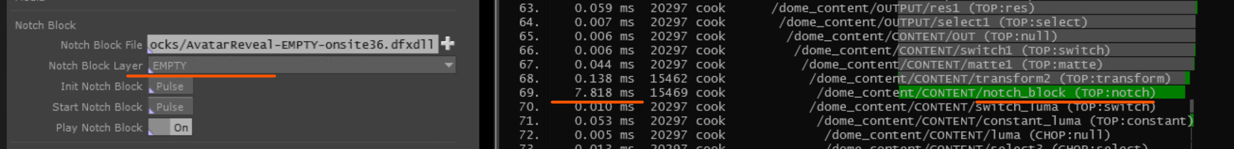

Is it normal for Notch blocks to continue to render content in non-active layers? As a test we loaded an Empty layer (with no nodes/default settings) and it’s still taking around 8ms to cook:
Reducing the total number of layers in the block from 15 to 6 reduced our cook time from 8 to 6ms on the empty layer, so it seems like other layers affect cook times. Could this perhaps be optimized so that invisible layers do not render at all (or at least, more minimally?)

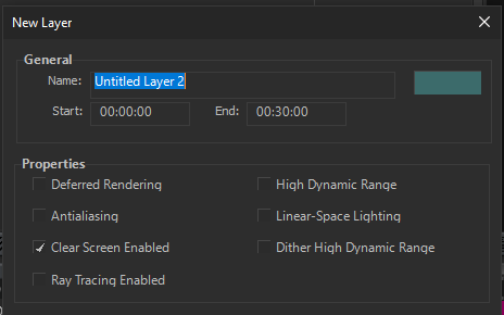

Do you have a large number of exposed parameters? Without knowing how TD’s (I presume you’re running in TD) implementation of the host works, I guess it’s possible that all exposed parameters are being sent regardless of if they’re in use on the active layer, which could cause an overhead if there are a lot (although I’d have expected this to have been hit elsewhere before). Or are you using any hardware devices (e.g. Kinect) through the Notch block? Those have a fixed overhead, although it’s generally on separate threads CPU-wise. Is your empty layer really empty? Is deferred rendering and AA turned on, for example? There are fixed overheads related to processing of those workloads, so it could inflate the time (although I wouldn’t expect to 8ms, unless you’re on a huge resolution and slow GPU.)

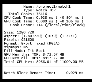

Looks like this might be a TD issue that has been fixed in latest stable. I re-exported the blocks into a blank TD project for the latest version Derivative pushed out a few weeks ago and, as you suggest, cook times are minimal for blank layers, even with exposed pars and many layers:
image image
For anyone else encountering this issue, I recommend to upgrade to latest stable, which also publishes the Notch Block Render Time in the info panel (middle click on Notch TOP) – very useful. Cheers.

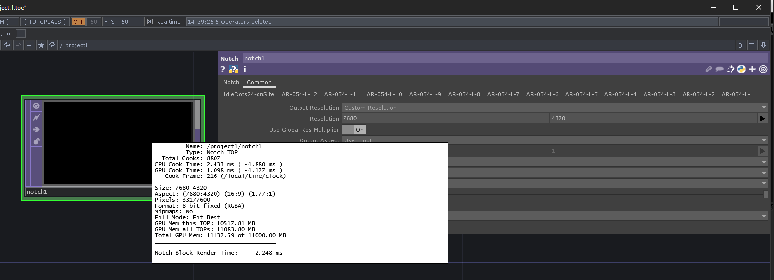

Further testing reveals that the same block rendered at 7680x4320 instead of 1280x720 uses over 2ms more compute… for a blank layer…

Firstly, I think there’s a basic assumption here that rendering an empty block inside a media host doesn’t rendering anything on screen, so it shouldn’t take any time. That is incorrect.
The frame+depth buffers still have to be cleared; the render from Notch has to be comped into the target provided by the host; and there’s probably another copy step on the D3D11/OGL texture on the TD side. All of these steps are very fast, but not free, and they have to be done for the block to be rendered. There’s also some potential sync overhead between OGL and D3D workloads.
7680x4320 is a lot of pixels - 36x 1280x720 (and ~18x 1080p). Doing some back of envelope calculations I’d expect it takes around ~0.1ms to copy a 1080p rendertarget on GPU, so 18x that starts to produce a figure close to what you’re seeing.
In summary, if you don’t want any cost from rendering a blank layer, it’s best not to render the layer at all (the best optimisation of all).
