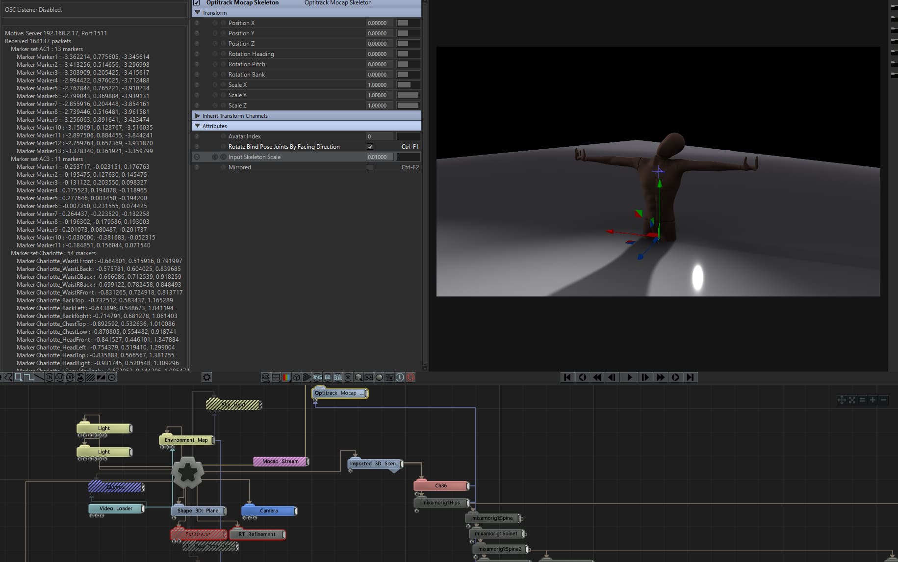

After testing with Motive 3.0.2, the problem still persists.
It’s definitely a bone naming convention issue, but the problem seems to be between Motive and Notch. No matter what naming settings I use on both ends, the result is the same,w even in the viewport visualizer of the OptiTrack Mocap Skeleton node. Only the neck and the head move.
Meanwhile, in UE, the data arrives perfectly.
For now, Our workaround is to capture the skeleton in UE and transmit video data through NDI, making it somewhat usable, but it’s obviously not optimal.
