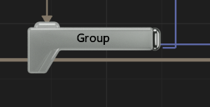

Hi everyone. I recently made a group of 3 nodes - a mesh emitter, geometry connector and a curl noise affector. I saved the project and a few days later when i got back to it the group looked closed
But when i double clicked on it
it looks like an empty group opening and closing. Also it looks like it has connections to the particle root and so on, but the entire geometry connector effect is missing when previewing the particle system.

That all sounds pretty unusual, so i;d be curious to see what changed. do you happen to have a dfx of the group before and after the change? Are you sure your double click to open is actually opening the group?
– Ryan
Hi i can upload the files in a few days, for now I just refrain from using groups. I tried several times double clicking on the group node and it animates as if it is opening , but it just has no border and nodes inside.
Also ungrouping it just deletes it and nothing is left behind.
