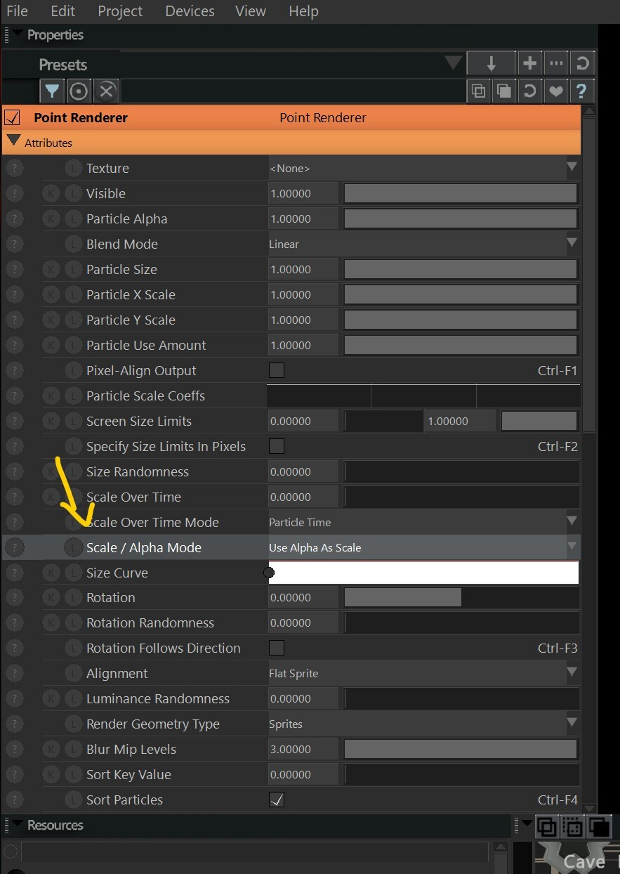

This might be what you’re after. To quickly give it a test, I’d suggest use alpha as scale on a Point Renderer and see if you get the desired effect? (second tip: the Size Curve underneath can be used to control the range of sizes you want)
Cheers man, will give this a go!

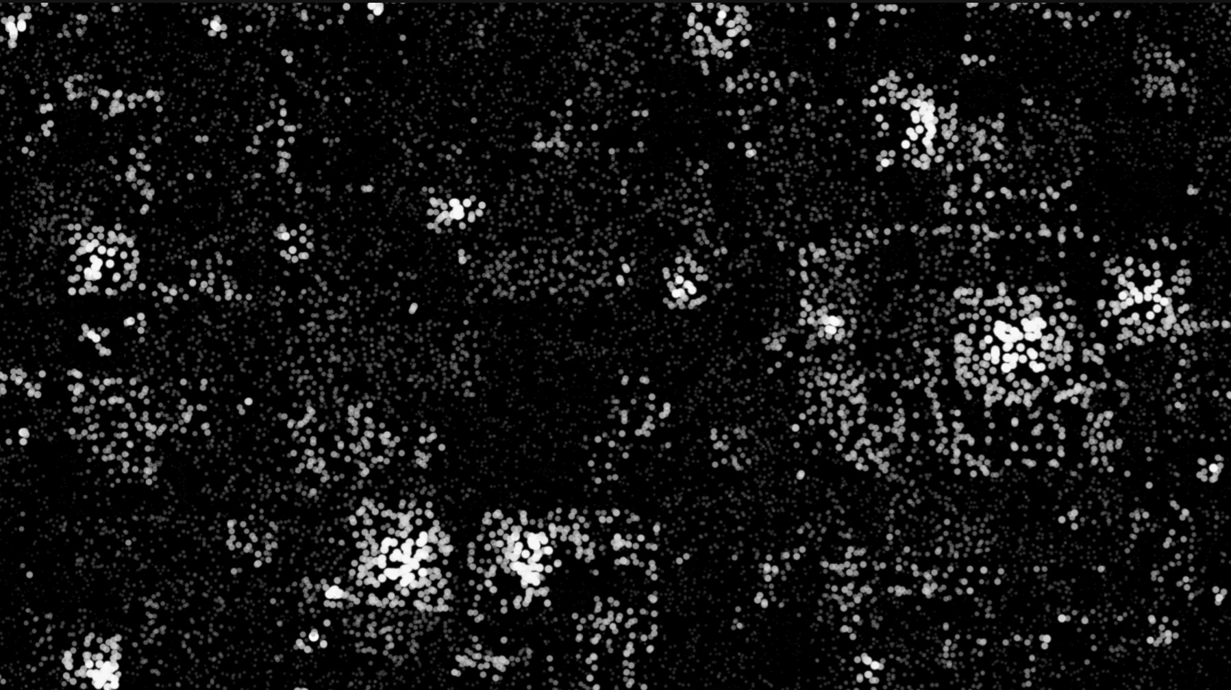

Is this what you’re after? If so, I got it working by using an image emitter instead of a mesh emitter, as well as fixing the alpha properly in Photoshop and creating a PNG with transparency (the second step might be redundant).
For …reasons… I can’t post an image of my node graph or the DFX though.
Nice! Thanks yeah I can see that working now!

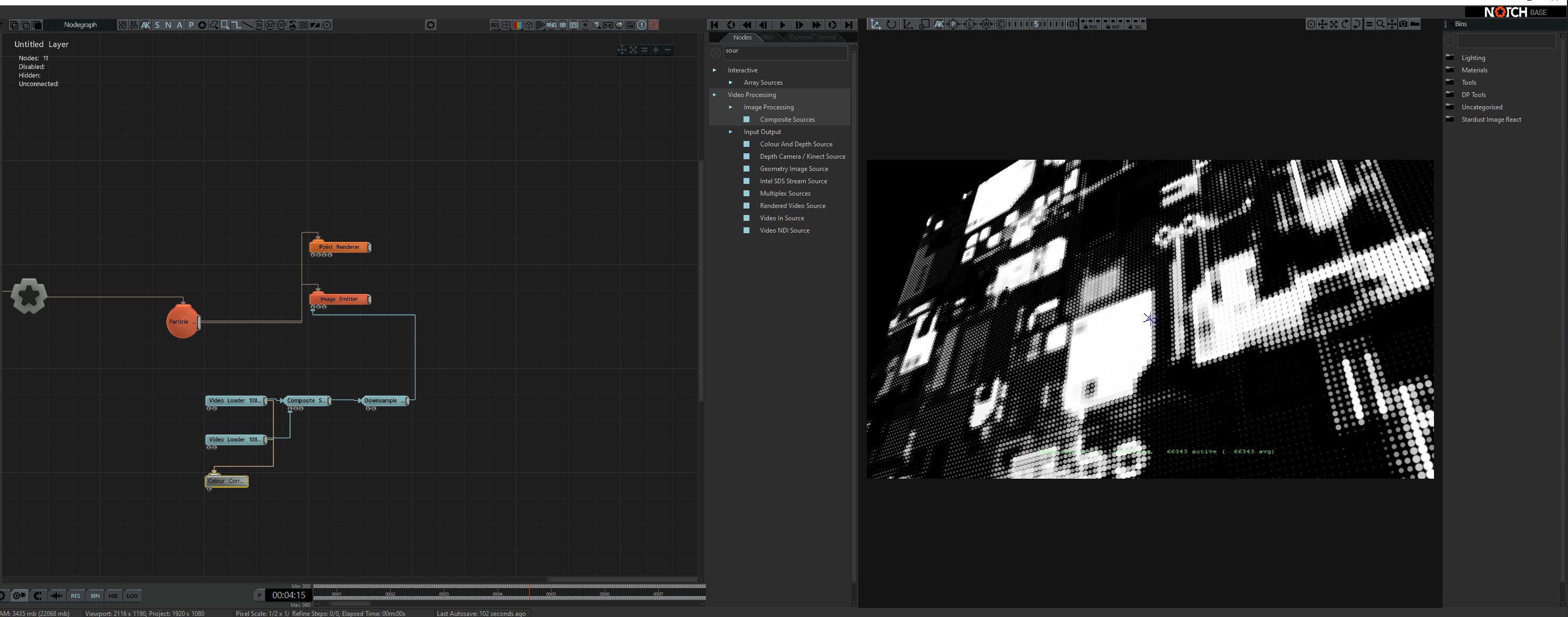

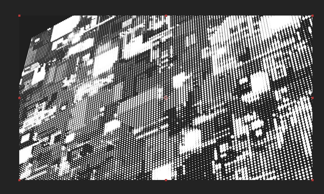

The reason i was using the mesh emitter was so i could emit across a plane, almost creating a grid-like effect, see below using Stardust. Is something like this achievable using the image emitter?
Will be my last spam i promise
Cheers

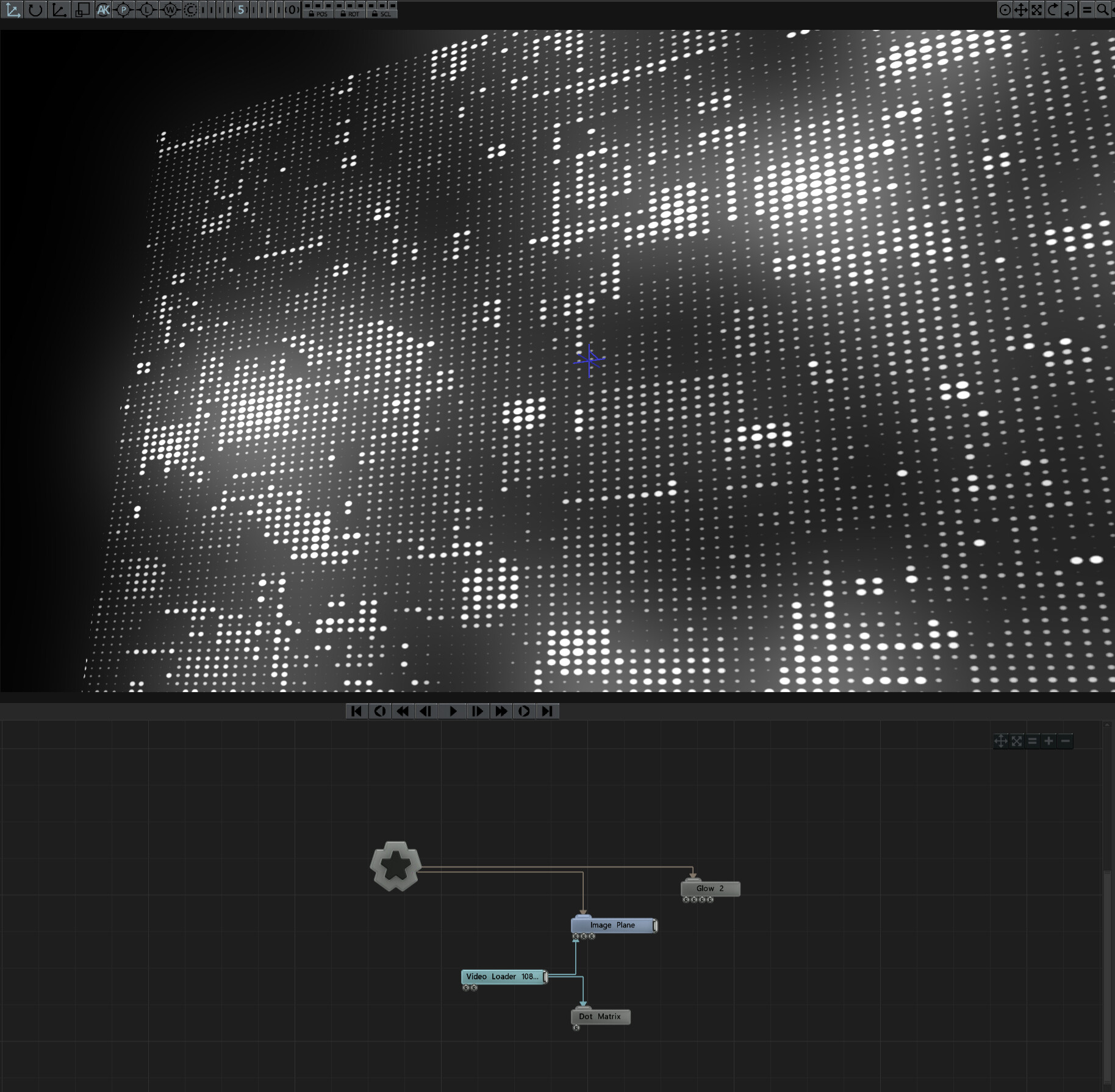

Hm, shouldn’t really be a problem to do that via a render to texture and slapping that on an image plane. But, if that’s the effect you’re after (and don’t need particles for depth), won’t http://manual.notch.one/0.9.23/en/topic/nodes-post-fx-stylisation-dot-matrix do (and be a lot cheaper)? It can scale by color/intensity.
Like so (glow added, because… well… glow)
That’s the effect i was after, but would be cool to be able to add turbulence, etc, which is initially why i went for the mesh emitter, and would add deformers after.

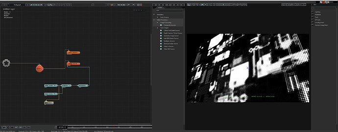

Think i pretty much nailed it - it’s just a case of limiting the emissions per pixel in the image emitter, then down-sampling the input, with the setting ‘point sampled’. It can now work with turbulence, etc.
Just thought I’d throw this in here if anyone else is interested.
