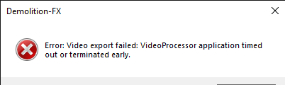

i’m experiencing a crash when i want to export a video from a project. it says :
“Demolition-FX Error : Video export failed : VideoProcessor application timed out or terminated early”

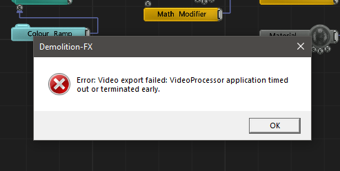

Sans titre - Notch Builder 22_06_2020 18_39_51
i’ve tried with my laptop gpu : 2080 rtx, on an other pc…actually i can’t export video from any project, even the templates…i really don’t know what’s wrong. Can’t work since 1 week on a big project with this issue
We are experiencing this issue as well, with 0.9.23.125.
Have tried on a P6000 and 2080ti. Also tried the regedit fix mentioned by @clementboghossian, no dice there either.
Here’s a video recording of how far the render makes it before crash, on average: https://www.dropbox.com/s/hbnptraynb2qzm4/2020-08-14%2017-44-52.mp4?dl=0
And here is the dfx for said project: https://www.dropbox.com/s/1541diz4zvs0qjw/ProjectNo2-0.1.6.dfx?dl=0
