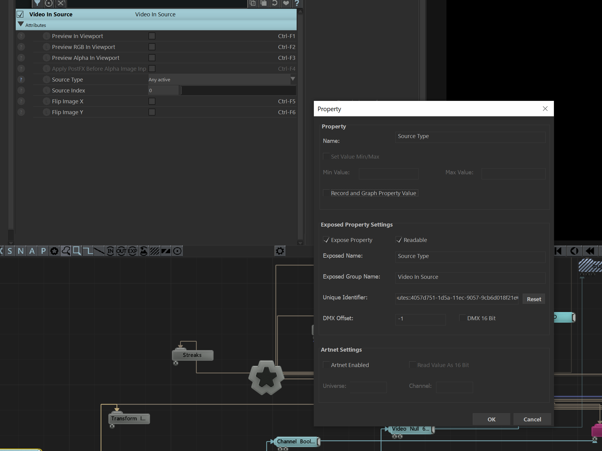

hey. i want to check my Notch Blocks (live IMAG) in Disguise but i can’t load the live Feed Camera into the Notch Block.
Maybe i did smthg wrong in exposing the Video In Source. I exposed the “Source Type” … nothing else.
right way?

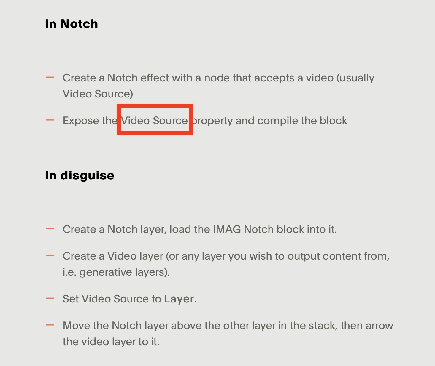

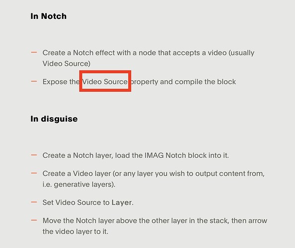

in the manual they mentioned the Video Source. That confused me.
What page is that? the Video Loader had its name changed a while back, so just needs updating.
– Ryan

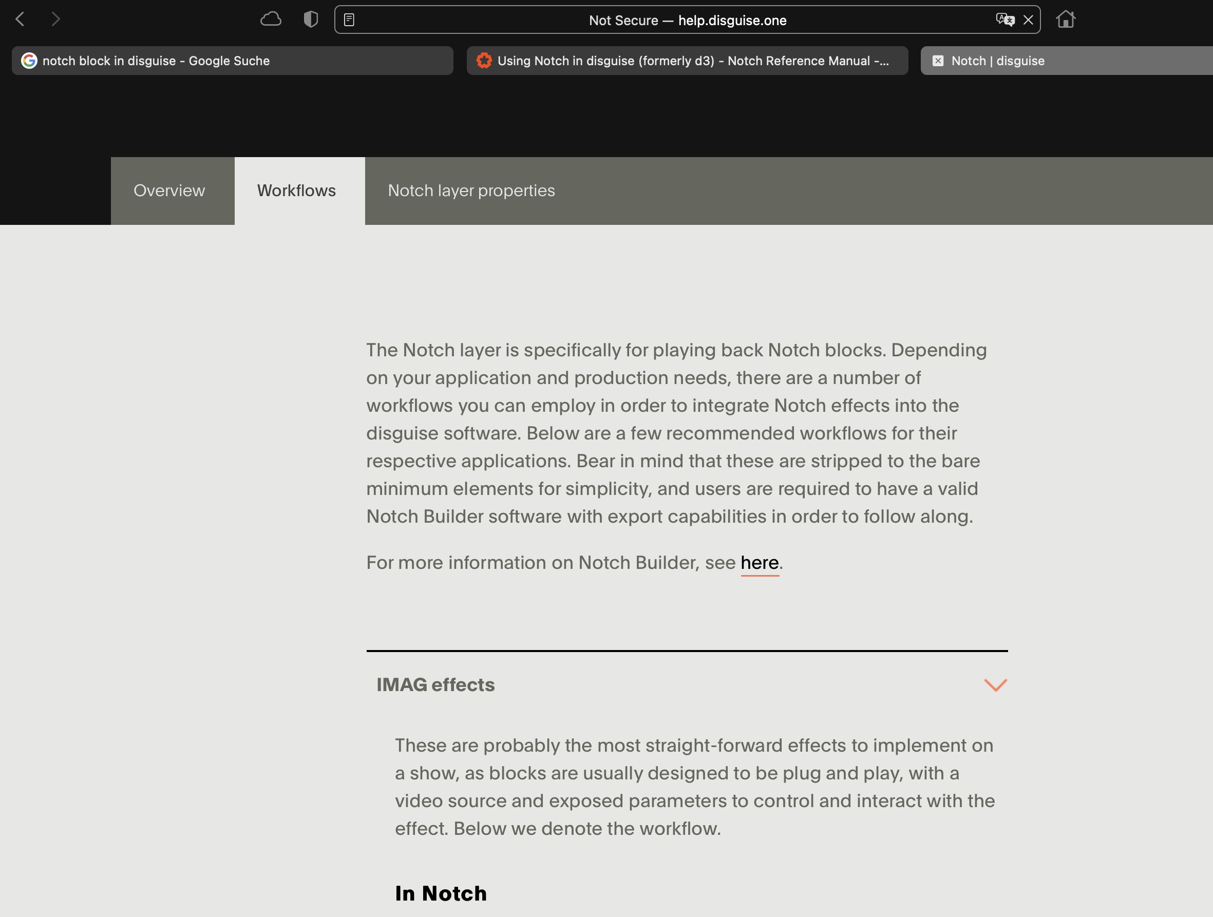

ist the disguise help site … but linked from Notch manual …
under Workflows / Image Effects
http://help.disguise.one/Content/Sequencing/Layers/Index/Generative/Notch.html
